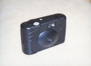

The Kodak MAX One-Time-Use disposable camera is available in two flavors: outdoor camera or flash camera.
To dissect the camera, you will need a mini-screwdriver set. To modify the camera, you will need a cutter.

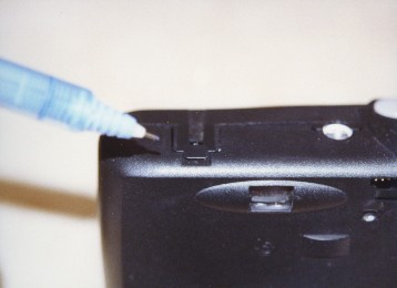

Each disposable camera body is held together by a set of tabs. The first set of tabs are located on each side of the body. Dis-lodge this set of tabs first.
Remove the packaging stickers covering the body. You will see the second set of tabs, located on the top and the bottom of the body.
After dis-lodging the second set of tabs, there is one last tab. It is located on the back side of the camera and will require a mini-screwdriver to pry it loose. Do not pry it hard, we do not want to damage the tab.
