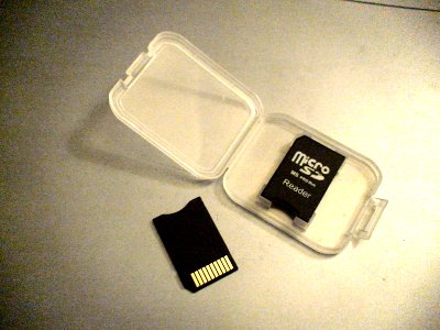

A week later, I received a yellow envelope from Taiwan. Inside is a plastic flash memory card container, much like ones for SD Cards and CompactFlash's. Except this container is specially made for Memory Stick Duo's. Inside the container are two microSD MS PRO Duo Reader.
I was extremely excited to have this adapter in my hand. I found an old SanDisk TransFlash 32 MB microSD card to try first. This is an old card. It's so old that not much could fit on it nowadays. So if I break it some how, I won't be too heart broken. I stuck the 32 MB microSD card into the adapter. Then I stuck the adapter into my Sony DCR-HC90 Handycam. The digital camcorder says, "Reinsert the Memory Stick."
