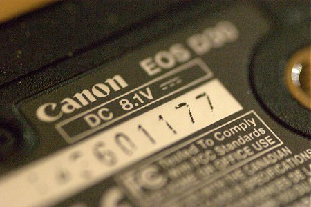

To answer question 2, I looked at the bottom label of my Canon EOS D30 and Canon EOS Digital Rebel. The label usually shows the power requirement specification. I haven't looked at the labels in years, because I have vertical battery grips attached to the bottom of all my DSLR cameras; covering the labels. It turned out that the Canon EOS DSLR cameras can handle DV voltage up to 8.1 volts (see photo below). Since the BP511 battery pack is rated at 7.4 volts, the Canon EOS DSLR cameras can handle electricity between 7.4 to 8.1 volts. I have a suspicion that it can even handle 7.2 volts (6 NiMh or 6 NiCd battery cells).
Being able to support a range between 7.2 volts and 8.1 volts gave me a lot of leeway. Because it means that I can also power the camera with five alkaline batteries. I jury-rigged several battery holders and several 9-volt snap connectors together to give it a try (see photo below). My Digital Rebel was able to turn on and initialize. I auto-focused and snapped away. It worked fine! Next step is to figure out how long the batteries will last. Stay tuned.
