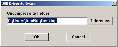

After downloading the driver mentioned in the previous section, double-click on it to start it up. The software will ask you where to uncompress the content (see screen shot below). Click on "Reference..." and select the Desktop. Click the "OK" button to continue.
