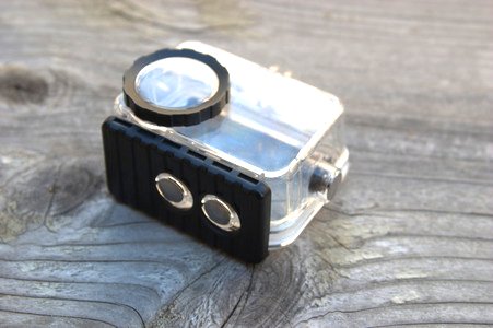

In order to be waterproof for deeper dives and rough adventures, an underwater case is provided with the action cam. Unlike the action cam, it uses GoPro mount rather than tripod mount (see photo below). Luckily a while package of tripod and GoPro adapters are included.
The underwater case comes with three buttons that replicates the three buttons on the action cam (see photo below). Unfortunately, you lose the touch screen functionality while the action cam is in this case. But the good news is that Akaso allows you to change setting using the three buttons on the case.
To get into the video settings, you use the mode button to switch to VideoSetup. Then press the shutter button to activate the menu. Once you are in the menu, use the power button to toggle between selections. Use the shutter button select. Same is true for photo settings. It's not as easy to navigate as the touch screen, but at least you can change settings under water.
The photo below shows the underwater case when it's open. A rubber seal surrounds the opening to prevent water from getting in. I've used this set-up in Hawaii in the sea. Not one bit of water seeped into the case.
