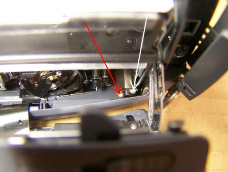

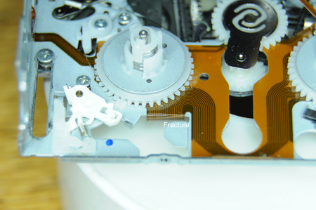

Okay I have been researching this a bit (tape door won't close) on my HC3 which seems to have the problem and I think I have tracked down the problem to the part. On the tape transport mechanism there is a motor that pushes downward on a latch to release the tape after the tape slide has been extended has been opened. The problem is that after mechanism releases the tape it is not moving out of the way to allow the door to be closed again. I have found that if I remove the battery with the camera off and then install it again... and then wait for the motor to move the little back up everything works fine. The weird thing is it doesn't 'feel' like a mechanical problem, when I pull the battery and place it back in the mechanism eventually resets itself with no problem. However, after ejecting a tape, I cannot even hear it try to lift the mechanism again so I am inclined to believe a senor or something is blocking it from opening.
I have attached an image showing the parts and it might be a help to anyone.
Anyone have any ideas?

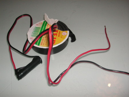

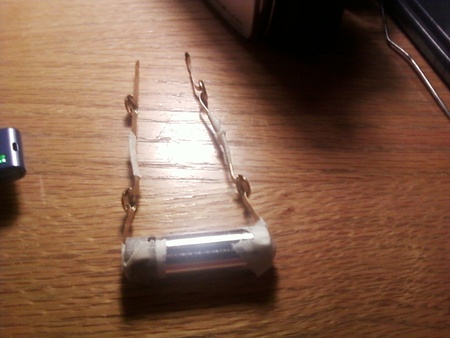

Does any body knows where the internal battery (Date Battery) is located in the Sony Handycam DCR HC28
Please I need some help before I trash the damn thing, Hurray SONY!, I guess I must love trowing my money away

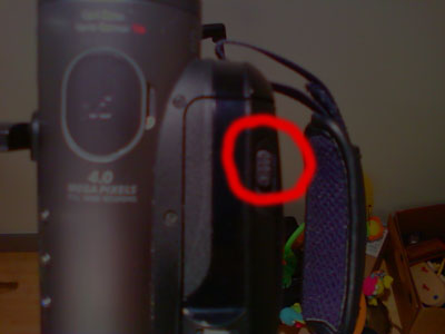

okay people...i think i found the exact way to fix the tape problem...my problem just started this morning...I have a DCR-HC28...completely forgot about the tape door open and was stuck with that damn code for about an hour...for the record, i tried banging on it and other dumb things like that with no luck...for the people that think they might have this same problem here you go...
power off the cam...make sure you have a tape inside already and you're holding it closed...hit the reset button a few times(2 or 3 times and the final time just hold for 10 seconds)...Now power on the cam and wait for the cassette noises...On the screen, it should say "re insert cassette"(or something like that)...let go of the door and take the tape out and re insert...once you hold the door closed again, it should automatically move the compartment back inside and you'll be able to close the door completely.
if this works for you, feel free to drop me a thank you note....i wont read the e mail...for the subject just put "THANK YOU FOR THE CAMCORDER FIX" lol

I had exactly the same problem, I took the battery off, powered on, then pushed the reset button for 15 seconds. I then put the battery back on powered on, shut the tape door and it worked. I am so thankful for everyones advise!! Thank you!

Okay people!
I think I have a solution that may fix most of your problems. I had this same problem with the cassette carriage not wanting to retract. We have been using some DCR-HC28's without tape, using just the DV out connector. Well, someone wanted to use a camera WITH a tape to record. We opened up the camera, inserted the tape, AND IT WOULD NOT CLOSE. We tried all methods mentioned in this thread with no success (was actually hoping that the "hit it on the bottom" method would work, but it didn't.
So, in desperation, I placed a cassette in the cassette carriage, held it closed with a piece of tape, took an adjustable lab power supply (since I didn't know what voltage I would need), turned it to 1.5V and touched the two little solder joints on the retracting motor with the positive and negative cables. Viola!!! The carriage retracted and everything is good with the world again.
I attached two pics. The red arrow is the positive cable and the white arrow is the negative cable. Since I used 1.5V to do this, you may be able to actuate the motor with a AA or C battery. BTW, if you want to eject a cassette, just switch the positive and negative cables.
Hope this helps some of you!!!

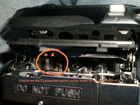

Dave
Mon, 30 Nov 2009 20:54:07 +0000
If you want a little closer view of the tiny motor, i have attached another picture. I'm hoping that this helps. It did for us as we were about to throw two fairly new cameras away.
Dave
Mon, 30 Nov 2009 21:00:05 +0000

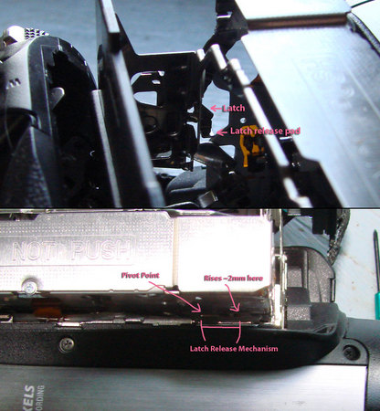

As far as the latch goes, Nick posted some pictures above that show the latch mechanism up near the viewfinder. That little piece moves up and down as the tape is being lowered or raised, and it should move after the tape harness pops out. When the tape mechanism is not working, that piece does not move into its proper position when the tape harness pops out. I think that activating the motor as you described causes this piece first to move into a position where the tape harness can be latched and the camera is able to detect that it is latched and can be lowered.

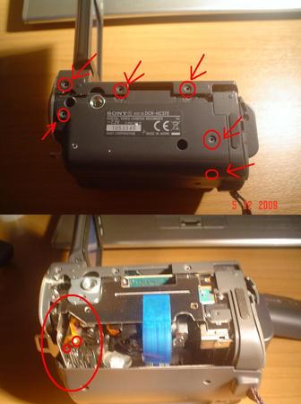

Allow me to introduce my self. My name is Constantine an i am an electronics technician from greece.
We have to understand that the DCR-HC37E like the other models use a mechanism to pull in and out the type tray, so it needs to know whether the tray is fully open and fully closed and for that there are tiny mechanical switches. in our case for some reason the tray looses alingment and it goes beyond the maximum upper point thus not allowing us to close it and thats why the motor will never move down. what i did is this: Do not hit your camera... you have to undo the bottom screws and remove the plastic that covers the mechanism's motor. apply 2,5 volts on the motor polarised in a way that will make the motor move the tray down. now try to find the exact point that will allow the type tray to close and stay closed. (move a few mm down and use your hand to close the rtay) when you do so then there is nothing else to do. re assemble your camera, plug it in and your type tray will work perfect.

I hope that will work for you because i understand that my method demands a variable DC power supply and not all of us have one at home or at work...
Any way it is good to know that we can fix it at No cost ! isnt it ?

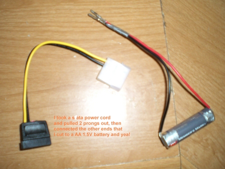

Kimberly, I used a C-battery and was able eventually to get it to work.
I took two lengths of wire about 6" long each and stripped the ends of each. I used electrical tape to attach one end of each wire to one end of the battery. Try to keep the loose ends of the wires from touching.
I then applied the wires to the contacts on the motor. You've got to have a good light source (having a headlamp-style flashlight helped me), and patience. It took me a while to get them on there -- even when I thought the wires were right in place, nothing happened. I kept at it and eventually got the hang of it and the mechanism started moving.
If I have to do it again, I'd find something stiffer to use as the probes to stick down into the camera, and attach the wires to those. I don't think a C battery is going to shock you, but if you do this you should put some insulating electrical tape around the probes where you will be holding them (just leave the tips exposed).
Jay

I have an hdr-hc3 and found the reset button. Resetting it did the trick for me. For the hdr-hc3 the reset is on the outer tape door in the middle. I had to use a paper clip and pushed it in and held it down for 15 seconds. Before that, I had tried - to no avial - just about everything else (ruining a tape in the process), except where they started talking about probes and voltage and electric tape. holy moly.

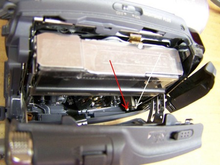

I have the sony DCR HC22 E, with the same problem en fix it by bending the limitation on the picture. Now the switch is working when I'm closing the door.
Klaas
Wed, 30 Dec 2009 17:37:54 +0000
Maybe this is a better picture.
Klaas
Wed, 30 Dec 2009 17:43:20 +0000

Now push the reset botton (small hole to the left of the "Display/Batt Info" button) and hold 15 seconds. Attach the camera battery and the tray should close. If it does not, disconnect all power, move the tape tray "in" 1 mm more, then push reset and again insert the camera battery.

My DCR-HC37 works well. Yesterday it didn't shut anymore. I red these messages, and the battery trick worked perfect! Thank you all!
I sticked a simple speaker wire on a 1,5V D battery. One wire on - and one +. With the other end I tried to get the motor moving. It went down straightaway. When it was completly down, I shut the unit. It works great now. The ony thing I need now is a bigger case, for the wire, battery, duck-tape and a screw driver.
It's very easy and safe to do.

Mon, 24 May 2010 21:39:53 +0000
Use a 1.5volt AA battery and feed a wire from the positive and negative of the AA battery to the motor and lower the tray, have the tray taped shut before hand and all power disconnected battery and power cable disconnected. I used a sata power cable modified like the pic I have and feed the prongs onto the motor until i lowers and the tape door shuts. Power on the camcorder and see what it does, might have to reset it maybe not. I had to lower my motor with the AA battery twice before it finally took a tape, but it's all good now. Don't bang or make your camcorder worst, just lower the motor and the error code goes away, might have to do it a few times. Thanks everyone from info above, thought I would make it a little simpler.
bertrenolds
Tue, 25 May 2010 03:24:42 +0000
Here is a picture of the motor on the HDR-HC# camcorder I have, it works! DO NOT THROW IT IN THE GARBAGE!
bertrenolds
Tue, 25 May 2010 03:26:23 +0000
And you do not need to remove any screws, you would probably make things hard for yourself. Whoever started thanks, Constantine you are the SH*T for figuring it out, thanks also dave. Glad everyone put their head together to figure this one out...

However, I did the fix the problem (for now) with the battery method. None of the other methods worked for me.
Thanks to bertreynolds too for posting the photo of his battery/wire device. Went to Radio Shack this morn to pick up the parts and used a 1.5 V "C" battery. Then did this:
1) took out the battery,
2) taped the door closed w/scotch tape (leaving a folded over tab in order to pull the tape off quickly when the door opened properly),
3) charged the nodes with the positive and negative wire, which didn't work at first so I switched nodes which then slowly lowered the tape door all the way,
4) pushed the reset button for 15 secs (which I don't really think affected anything at all),
5) charged the nodes again for good measure
6) put battery back in and turned the camera on
7) opened/ejected tape door & pulled tape tab off fast
8) inserted tape, but the door will only close if I switch the camera off and then back on to either camera or vcr mode (HDR FX 1000 doesn't have an "ON" only position).
This seems to do the trick for now. Thanks everyone!

Ok, I would like to try the battery method but need help first with another problem. Before the posting for using the battery on the motor contacts to raise and lower the tape housing I had tried the banging method and got more than I had bargained for. A piece fell out of the camera and not sure where to put it back. Was wondering if someone with a HDR-HC3 would not mind looking inside their unit and see where this piece might have come from. I have attached pics of the part and inside my camera. Any help would be very much appreciated. Just hate tossing a $1K cam. BAD SONY BAD!!!

Thanks Dave and Constantine (Nov/Dec 09). Used your method on a DCR-HC37, I used a 3 volt watch battery, I took the bottom off the camera for easy access to the terminals as there's not much solder visible from the top. A BRILLIANT SOLUTION!
Dan (UK)
Mon, 20 Dec 2010 22:26:16 +0000
I have DCR HC26 Used two C batteries in series (end to end like in a flashlight). Took the cassette tape out to be able to see the motor (did not have to unscrew or remove anything). Touched the two 'bumps' on the motor with wires (see runamuffins picture)- red (positive) wire to the left and the black (negative) on the left bumps. Heard a noise from the motor and now it worked. I tried this after taking out battery, resetting, whacking etc.
Thanks much.

bertrenolds ( 25 May 2010) your solution is a winner! Apply 1.5 volts from a AA battery( see photo) to the motor and the tape cover closes! To hell with Sony , from a deceptive manual, to a faulty product, this was the last product I will purchase from that company!
Since I'm on vacation I had to improvise a fix with the materials at hand. Tape is from a first aid kit and the "wires" are paper fasteners flattened out I used two taped together for a length of 10 cm ( 4 inches)

I had same problem with my Sony camcorder - try this one guys - when you open the screen on the side, there is a small RESET hole. I carefully pushed it with a paperclip, & the cassette door now opens. all you then have to do is reset the date & time.
hope this helps - it sure did with me !!

The Dave/Constantine/and all battery to power motor method worked great on our DCR HC38. Nothing else worked -- battery in and out, reset, holding the door closed, etc.
It took longer to get the battery and tape the wire to it than the actual fix.
Touched the leads until I heard the motor move a little. Closed the door and it stayed. Then it descended. Reset for 15 secs.

I have C:32:11 error and not closing casset bay in my Sony HDR-FX7 camera. I use hot-wiring the motor, nothing else helps. I use the camera battery as a power sourse. With this I close the casset bay and after camera reset everything works properly. The motor looks like cylinder with 5-7mm diameter and with 2 small hemispheres on the bottom. The motor is situated in right-bottom side of the bay.

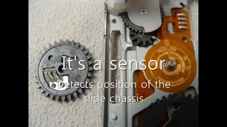

I solved the problem easily by following this totoriel
http://www.youtube.com/watch?v=RSnyDtJOu6k
the problem is stupid, it is due to a small gear that gets stuck

After trying all other ways mentioned here I went and got a C type battery and cable (used the cable from a broken pair of headphones I had lying around so no need to go out and buy cable if you've any old broken electronic equipment lying around.
It frickin worked!!!
The first time I tried it I forgot to press the "reset button" for 15 seconds after getting the tape deck to close, so when I tried it again I had the same error message and it wouldn't close again. I applied the cables the same way again but nothing happened. Oh that's it I thought, the motor probably got burnt out now or something... but then I realised that the battery was spent after the first try, so I used a different battery from the same pack and it worket. After resetting I've tried opening and closing several times and it works!!! If it happens again I know how to sort it. Thank you sooooo much!!!
I'm so happy!

I have a sony dcr-hc27e that had the same problem: the tape door didn't closed and the C32:11 error written. Sony assistance in Padua (Italy) said us we have to change all the mechanical parts and it would take us 120 euros (the price of a new similar cam is since 180 euro). We followed some of the advices written in these place, we reached the solution:
I closed with some tape the cassette carriage, I took an adjustable lab power supply (since I didn't know what voltage I would need), turned it to 1.5V and touched the two little solder joints on the retracting motor with the positive and negative cables. The carriage retracted and everything is good with the world again.
Now you can put the battery on and make the door work right.

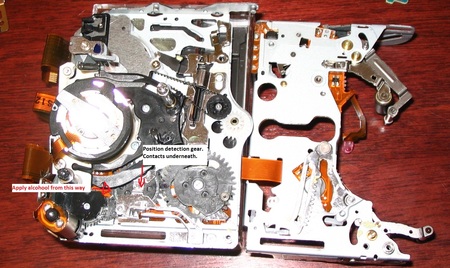

Had the DCR-HC47 camera with the door not open problem. Searched on internet to see what the real cause is, did the motor boost, reset, etc, only works for one time.
Found a video on the youtube how to replace the position detector gear, opened the camera up to the mechanical parts - see picture. Cleaned that gear and the spring contacts, put everything back and it worked, for couple of times, then again, same door not closing. Then it hit me, I did not even need to take apart the camera, just open the bottom cover to gain access to the gears motor, the one that has to be boosted, bring it back to some mid position, so the cover will close.
Now comes the stroke of genius, you need to use a small syringe and put some alcohol ( couple of drops) to that position gear, holding the camera upside down, so it will not drip on the heads.
Replace the battery and do some cycles of close and open the cassette compartment.
After I applied the alcohol I did around 20 cycles, no fail.
I think the grease used on that sliding position detector was aging and causing the contacts to open, thus confusing the CPU about the position of the mechanism. I used 99% isopropyl alcohol.

I smashed it a few times as recommended then noticed one of the posts mentioned "reset button".
Tried that and it's all good! Long live Mini DV!!

Used the battery to the motor solder points trick and retracted an otherwise uncooperative tape tray. Thanks to Dave and Constantine!

Used the reset button. Finally it worked. Did not use the hitting method, since I don't seem to know my own powers (LOL). But it seems to be fixed now, so fingers crossed!

I think the picture explains it all..
Youtube has a video... http://www.youtube.com/watch?v=RSnyDtJOu6k
In Effect the !!BASHING!! does the same thing, just more harmful to your machine

I managed closing that door 3 times using a battery 1,5V solution with wires.
After a while the problem has returned and currently battery solution doesn'f fix it....
I replaced a battery for a new one, connection is ok (checked with small bulb). What has happened? Is there a chance that a motor was burnt? Should I try with a higher voltage? This camera and Sony cost me so many hours and nervous that I'll never buy anything from Sony... What a shit !

Have just managed to fix this problem on my HC35E. After several try using reset in different ways tried the following:-
- Battery fully charged
- power switch set to on
- pressed reset for 15 seconds
- on release motor responded
- time set up screen appeared
- now seems to be working OK
- for info there is a nastly little warning in the manual to run the cassette deck for about three mimutes periodically. This may help to avoid the problem.

I have a HC37 and used an 1.5 Volt AA battery to lower it slightly. Thanks to the comment made on 8/1/2012 I realised that if you lower it too much you get error C32:23 re-insert tape. So it really needs patience to get the thing in the right spot. If too high, error C32:11 (it will not close), too low it will close but you get error C32:23. Trial & error. Also in order to put the wires, the camara needs to be in the off position. Be patience and you will succeed!

Like i said tha 2.5V (jump start) method worked fine for me and i never had the same problem ever since.
Glad that i could be of service

error code C:32:11 extremely common fault with the Sony HDR-HC1, HDR-HC3, HDR-HC5, HDR-HC7, HDR-HC9, HVR-A1, HVR- HD1000, HVR-V1 and other model handycams with the same mechanism assembly.
Most of the time the flex that connects to the sub assembly and the cassette compartment becomes torn due to the tape compartment moving in and out when putting & taking out your tape.
We use to replace the faulty flex but found out that it was an extremely short fix & time consuming. The only reliable way of repairing the fault is to have the complete sub mechanism assembly replaced.
Bit annoying i know, but not much can be done to avoid this fault. But we do lay down a protective layer so that it lengthens its life span before the fault reoccurs.

Hi, my name is Robbert from Holland (Europe).
Today a found my old Sony Handycam DCR-HC26 which I hadn't used for years.
To my surprise it wouldn't close anymore with or without tape.
Error code C32 C11
Found the following 2:40 minutes Youtube instruction AND IT WORKED!!!!!
With some tape, a small flash light and a small philips head screw driver it was easy to solve.
http://www.google.nl/url?sa=t&rct=j&q=&esrc=s&source=web&cd= . . .
Greeting, good luck and happy filming!!!!!
Robbert Smit
Tue, 09 Sep 2014 20:51:09 +0400
Hitting the camcorder didn't work for me but shaking while holding the door shut worked! Go Figure!

Mr Smit above is exactley right. The door wont close because the switch under that gear in the video isnt making contact. Its better to use a small screwdriver to Gently wiggle that gear to help make contact than to bang on unit and hope no further damage happens. It must be gentle wiggling though. Pressing down hard on the gear will tend to bend the switch sensing fingers even further away from what they need to touch. After wiggle and repeated attempts, the door will eventually be ready to close. The proper fix is a total disassembly to pull that gear out and clean and grease the switch under the gear. A very tedious and highly delicate process.
stts

HDR-FX7 Sony Digital HD Video Camcorder - After several unsuccessful attempts to reach a living, breathing repair person at Sony, I called their sales line... which got me transferred to a technical support person... who recommended shipping my camera across the US to Connecticut without a clue as to what it might cost and whether it could actually be repaired... The better part of the next day was spent calling numerous regional repair shops & dealers in my area who suggested damages could run as high as $1,200.00... YouTube was somewhat helpful, but Thank God, I found camerahacker.com... which has what I consider the BEST Thread I have ever read!!!
Thank You to everyone who added details, regarding using a homemade AA battery device to recharge the retracting motor when tape door won't close... Had to jump-start it more than once, but, for me, the third time was a charm... My comments repeat several already posted, but rather than try to refer you back to previous posts, here is my summation:
1. Be Sure to remove video tape, camera battery pack & power cord, if attached.
2. Switch camera to "On" position.
3. Scotch-tape transport basket door closed temporarily, leaving a piece of tape sticking up so you can remove tape when basket retracts.
4. Touch positive & negative nodes on retracting motor with wires which are attached to homemade AA battery device... wait for basket to S-l-o-w-l-y retract... (refer to photos with older posts to see location of nodes).
5. Close tape door.
6. Using end of pen or pointed tool, hold in camera "Reset" button for 15 secs (see your manual for location of "reset" button).
7. Reconnect battery pack & power on camera.
8. Press "eject" button to open tape door.
9. Insert New Blank Tape... wait for transport basket to retract... Try using camera for short video... If any error message appears... turn camera off & then on again.
10. If there still appears to be a problem... eject & re-insert tape.
Note: 1. If transport basket will not retract again... repeat above recharging steps using AA battery device (not necessary to hold down "reset" button this time).
2. If transport basket still does not retract after recharging a second time... Leave camera switch to "On" position... remove & re-insert battery pack... turn on camera to see if basket will retract.
3. It appears as though the retracting motor may recharge, but sometimes not activate transport basket until battery pack has been reconnected to camera.
4. You may have to repeat recharging steps above several times for successful outcome.

Thank you to everyone before and good luck to anyone seeing this in the future! Try everything you're comfortable with and then some. Different cameras have different solutions for the same code.
Tried different fixes for two cameras, HC21 and HC28. The whack worked on the HC21. For the HC28, the video from 2010 where you remove the battery & CAREFULLY Press down on the mode gear with a small screwdriver was the only thing that worked for my favorite HC28!
It's a temporary fix though. I got the error again a few days later. But I did the same thing and it worked again.
Video: https://youtu.be/RSnyDtJOu6k?si=PMiFRN7gGhkqkpUh
If the whack works your problem will remain a mystery but at least it works and probably wasn't that bad.
If the temporary screwdriver fix works for you then congratulations you know your problem! Unfortunately it requires surgery to fix permanently. It's The mode gear and golden sensing plate. Like the video and description says, they might need to be cleaned. Good luck!
Tips:
DO NOT put too much pressure on the mode gear. Remember you're just pressing it against a sensor not stabbing/prying it.
Yohan
