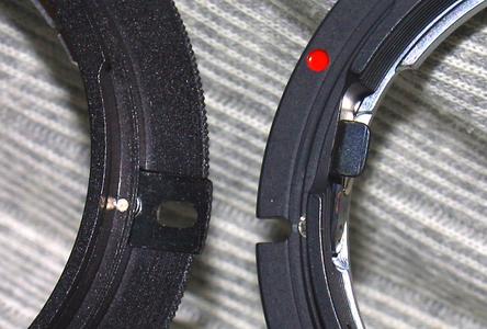

I have just received one of the chinese $25 adaptors.
It is quite good fully machined with bright finish.
Unfortunately I tried it out on the first lens I picked up - It fits snugly enough - but has no release lever and I cannot work out how to get it of. I presume I need to push back some sort of spring loaded clip with the blade of a screwdriver but cannot find one that moves and lets the lens rotate.
Can anyone help.
The device was in a plain box and works fine on both mounts although manual only of course.

Holy Hell! did i have a time trying to figure out the cheap version of the nikon -> eos adapter! Anyway, i got my version from ebay from kawaphoto, the whole deal cost me 16$ shipped but an hour of confusion and panic. However, with some patience, jiujitsu grip, and most importantly LUCK, I was able to figure it out and they work great! I've got some old AI/AIS Nikkor Lenses (50mm 1.2, 24mm 2.8) that adapted just fine and metered quite well on my 40D. However, I think once you start venturing in the smaller apertures; the metering gets a bit thrown off; can't say for sure though. I'll have to check and post more about that later. Anyhow, if you decide to purchase this fantastic deal and get confused along the way; i'll definitely give you my 2 cents on how to trouble shoot you're way out of a dreadful time.
Dae Hans
