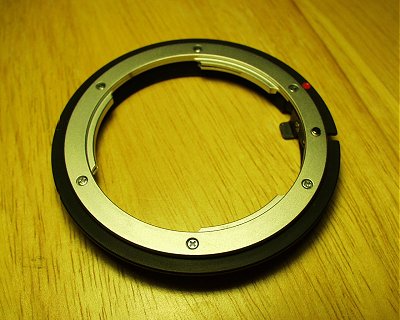

The Novoflex lens-to-body adapter arrived in a plain, white, no-nonsense package. It only had a product identification label on it. No fancy packaging like those found with multi-million dollar manufacturers, such as Canon or Sony. It included a very simple instruction sheet and the actual body/lens adapter. The instruction sheet is single-sided with both German and English. The English is quite poor, obviously translated by a non-native English speaker.
The adapter is very thin, made out of two metal layers. The metal lens mount ring is silver and is friendly to Nikon mount. The metal mount behind the lens mount ring is dark and flat in color; it is friendly to Canon EOS mount. I assumed the two different paint and material is designed so that less friction is produced when attaching and detaching the adapter from the camera body. But then, I did not currently see any problems with my lenses and camera bodies where the two mounts are made out of the same material.
Nikon lens rear element and mount. Novoflex EOS adapter mounted on the Nikon lens. Note the little tab for lens release.
The instruction manual suggested that the adapter is to be attached to the lens first. Then the lens and the adapter are to be mounted to the camera body. Removal of the adapter is the reverse of the attachment process: first remove the lens/adapter combination from the camera and then remove the adapter from the lens. To remove the adapter, a little tab has to be pressed down to unlock the lens from the adapter. It was really difficult pressing down that tab. I felt that the lens release could have been designed a little better.
I have tried mounting the adapter to the Canon camera without the Nikon lens. It was an fun exercise, but the adapter was extremely hard to remove from the camera body. I had to mount the lens on the adapter, remove the combination, and then remove the adapter from the lens.

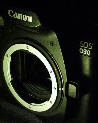

Based on the above passage, I assume they are talking about Nikon lens with rear element that sticks out quite a bit. It might contact the mirror in the Canon EOS SLR, causing damage. Got a better interpretation? Let me know. I tried two Nikon lens with this adapter on my Canon EOS D30, without any problems. The two lenses are: 1) Sigma 17-35mm D Aspherical EX Lens; and 2) Sigma 20mm f/1.8 D EX DG Aspherical Lens.
The lenses work quite well on my Canon EOS D30 digital camera. However, operations will be a little different from a normal Canon EF lens. Since the adapter does not provide any electrical contact translation, the Canon camera and the Nikon lens does not communicate with each other at all. The only electronic feature that the Canon EOS camera can perform through the Nikon lens is the through-the-lens exposure metering function. The Nikon lens has to be set to manual mode, where the aperture and focus is set on the lens.
A Nikon lens mounted on a Canon EOS camera. The adapter is so thin that it is virtually unnoticeable.
Unlike Canon EF lens, Nikon lens has an aperture ring on the lens. The aperture ring can be set to any f-stop supported by the lens any time, permanently. It is like having an automatic depth-of-field preview button. Since there is no electronic communication, the Nikon lens can only be used in manual focus mode. It would be wise to turn the aperture ring to the wide-open setting for focusing, then stopping down for exposure metering and then the final shot.
