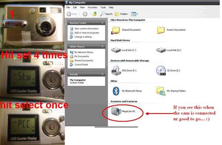

Hey dude I had the same problem but I found a fix for it... http://downloads.sakarhelp.com/80379.zip
Install that driver... Its in a zip format so u will need to unzip it with a software like winzip or winrar...
After U install it... before u plug in ur camera turn it on and press the set button 4 times ... the display will say SEo... Hit the select button once... the display should now say PCC... PLug ur camera in via usb now and it should be detected as megacam... it can be used as a webcam now... The quality is pretty cool too... Good luck...
