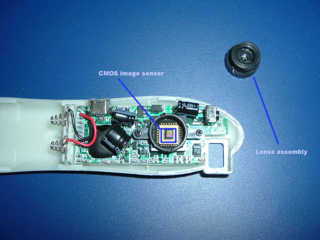

Cool! Got any pics of the inside? Is there an actual IR-blocking filter?

Anyway, the camera does have an IR filter on it, but it's in such a way that I need to remove the lense to get at it. Unfortunately, the lense looks like it's glued in place and there may be no way of getting it out without damaging it. I suppose if I really wanted to, I could search for one that would fit in and break the lense and IR filter out of it.

Cool . . . have you try shooting pictures without the lens and see what kind of results you get? Without the IR-blocking filter and with no replacement clear glass, the camera would focus very close. You can get some extreme close up pictures with it. Though I don't know what kind of picture you'd get with no lens and imaging directly on the sensor . . .

throw it away... they melted the lens/ir into place... yeah, real bright.
