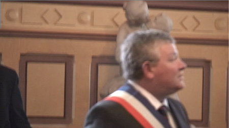

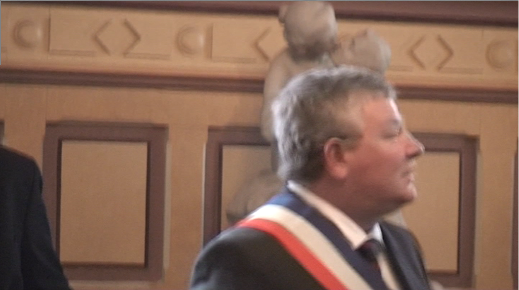

I had the same problem with my Sony HDR-HC7, once when I was in Montreal, Canada, filming in cold weather. Another time, it was during a wedding in France: during the first hour, the video was clear, but at the end of the ceremony, suddently the image went fuzzy. I attach a screen capture of a frame showing the fuzzyness of the video. It does not look like a out-of-focus situation, it seems that the interleave lines are shifted, creating a double image. The effect disappears after having powered off the camcorder during several minutes. I think the issue is related to the temperature.
