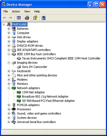

Ok, your IEEE 1394 (Firewire) controller driver is installed correctly. But I don't see any imaging devices or the Sony DV Camcorder driver. Make sure there aren't any unknown drivers (? mark) in the list. And make sure there aren't any non-working drivers either (! mark).
When everything is working, you will see the following drivers in the Device Master.
