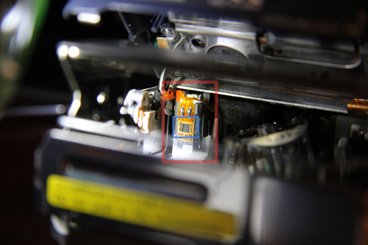

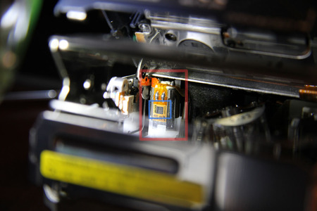

Just MAYBE when one gives it a tap on the bottom, it results in the reset button being actuated. NOTE THE LITTLE HOLE in the bottom market RESET.
--- Then stick a paper clip point gently in that hole and you can feel the button click. Watch the error code 21 go away. Voila!
Please do not strike the box again. owch

Ok. Here's the deal. I have an HC1. I found out somewhere in the net that cleaning a sensor (It's a black sensor at the back left side inside the cassette compartment between 2 solder blobs.) will help. Well, it didn't. I tried re-setting the camera with that small pinhole several times. It didn't help either. My last resort is to hit it just like what many have been successful here. I love my camera so I have it a good tap. Ooops, it didn't work. I tried to hit it harder at the cassette door side. Didn't work. My palm is already aching after 5 or 6 hits. Nothing worked. Finally, I closed my fist and gave it quite a hit. IT WORKED! LOL! This must be the most amazing solution ever. Sony may not like it but this should give them a lesson. What if mechanical trouble happens and if it is still under warranty? They must be fixing a lot of mechanical troubles.. Ha, ha..
Bob Jameson

This error is usually caused by failure of, or contact failure with, the dew sensor. On many models this is a black square mounted on a metal pole with a flexicable coming from it. The flexicable conductors can split and give rise to this intermittent fault. It is possible to patch out the faulty flexicable with some thin wire soldered from the dew sensor to the socket where it connects to, or replace the dew sensor. It's fiddly, but with care and about an hour or so of determination, the fault can be repaired by a good electronics enthusiast.
What's interesting about the dew sensor is the resistance actually goes up when it is damp, so an open circuit connection makes the machine thinks there is dew on the heads. What chemistry is in that sensor is something of a mystery!
Colin

Hey ppl out there.
Had the same moisture C21:00 Problem with my Sony DCR-PC4E and found a solution here:
http://www.dvinfo.net/forum/sony-hvr-a1-hdr-hc-series/88013- . . .
Take a Q-Tip soaked with alkohol (I took sterilium) and clean the blue spottet area like in the attached picture.
Wait 2 mins until the alkohol evaporated and turn your device on. Should work :).
