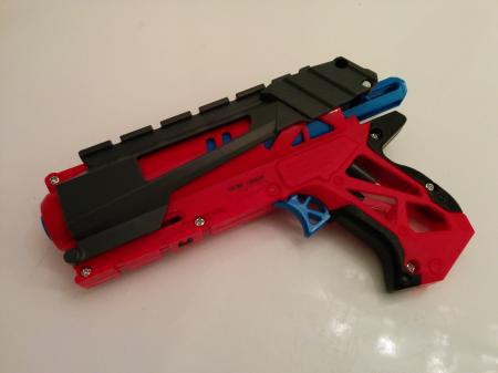

I am going to use a small toy gun to show effective distance and scale. The gun is show below. I am going to try taking photoa of the gun with the IR torch and each SmartPhone.

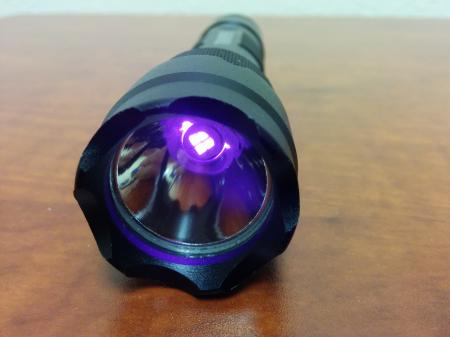

The photo below is taken with the Google LG Nexus 5. It is taken at the same time that I have taken the Apple iPhone 5c photo aabove
As you can see in the photo below that the IR torch is emitting infrared light. The Google LG Nexus 5 also has a IR filter, but it is not as strong as the IR filter in the Apple iPhone 5c.
