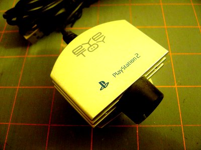

As mentioned in my "IBM PC Camera Disassembly" article, I've been trying to modify my web cams to see IR/UV light. But, so far, the IBM PC Camera hasn't made it easy. So I decided to take apart my Eye Toy (see photo below) and see if I can remove the IR/UV glass filter. And the procedure is documented here.
The Sony Eye Toy is a small web cam. There aren't much space to hide fasteners. So I poked around the product below and found two screw holes. The photo below shows one of the screw holes. The other one is on the other side of the label.

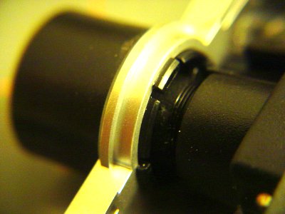

The front lens element is being held onto the case by four plastic tabs. Photo below shows one of the tabs. The only way for me to remove the front lens element is to rotate each one to the top and push each one downward.
