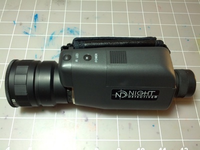

At first glance, the Night Detective Quest 5 looks like a miniature old-school camcorder. It's got a big lens on one end and a smaller eyepiece on the other end. On the right side of its body is a hand strap. You hold it just like an old-school camcorder.

There are two control on top of the monocular. The one labeled "IR LED" turns on infrared LED lights to light up the scene. The second buttons is the "Power" button.

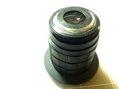

The front lens element looks like a simple plain glass without any coatings (see photo below). It has a 52 millimeter filter ring. The monocular comes with pinhole lens cap that screws onto the 52mm filter ring. The pinhole lens cap allows you to try the night vision monocular during the day or with the lights on.
The front lens element is rotatable by hand. It allows you to change the focus on various distances.

Above the eyepiece are two LED indicators. The lower indication shows the power status (whether the device is on or off. The higher indication shows whether the IR LED is on or off.
