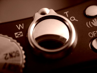

Try the widest zoom angle. Then try the telephoto zoom angle. Some digital cameras can focus really close to the object at the widest angle, while other digital cameras can focus really close at the telephoto angle. Most consumer digital cameras usually provides the closest focus distance and the largest object image at the widest end of the zoom. But you'll never really know unless you give it a try (or unless you read the camera specification very carefully).
