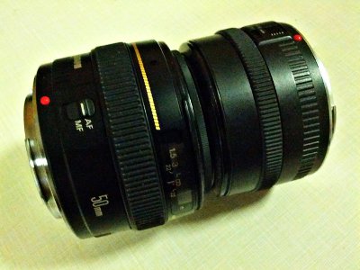

Extension tubes are also called extension rings and can be interchanged with other lenses to get a closer focus. Extension tubes extend the focal plane to gain maximum magnification. Using extension tubes requires a longer exposure time because of the loss of light. Unless your extension tube has electrical contacts, you will not be able to use the autofocus on an automatic camera; meaning you will have to manually focus the camera. The newer, more expensive extension tubes come with electrical contacts.
You can get an extension tube for nearly every single lens reflex (SLR) body that can be attached to a variety of different lenses to attain different effects. Plus, they do not cost as much as dedicated macro lenses. Generally speaking, the greater the minimum focal distance, the greater the magnification. In fact, the lens creates a "narrow focus zone", in which an object can be focused. For example, with a 50mm lens and an extension tube, the minimum focal distance is about 4 inches with a depth of field that is extremely narrow.
Pros
Enhances the lens capability, gives a degree of macro capability, allows a lens to focus much closer, allows you to convert most lenses into a macro lens for much less cost. No additional lens to deteriorate image quality.
Cons
Loss of light, which increase exposure time and may require you to manually focus.
