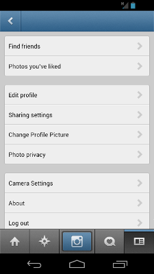

Another solution is to configure Instagram to use the built-in Android camera, rather than the Instagram camera. You can do that through the settings in your profile. So go to your profile in the Instagram app and tap the menu icon (the three vertical squares as shown in the screen shot below).
After tapping the three little squares, you'll end up with the profile setting as shown in the screen shot below. Select "Camera settings".
After tapping "Camera settings", you'll see a page with a single option Deselect "Use Instagram's Advanced Camera" as shown in the screen shot below.
Once that option is deselected, Instagram will use the default camera app when you try to take a photograph in Instagram.
