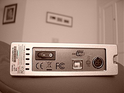

The USB cable has a Type A connector on one end for connecting to your computer. The other end of the cable is a Type B connector for plugging into the drive. The Type B connector looks like a house and is commonly found on USB printers.
The AC adapter has a proprietary four-pin plug. This plug provides separate 5V and 12V power and ground. That's the first time I've seen an USB enclosure with separate voltage source. I had hoped that it was a basic power plug so that I can source a power adapter in the future if necessary. This proprietary AC adapter ruined my plan.
An small on/off switch is in the back of the drive. The hefty USB enclosure is a good sound insulator. The drive emitted no noise when powered on. You'll only know that it's on if you place your hand on the drive or the table that the drive is sitting on. You can only feel the vibration of the 7200 RPM drive spinning. A cool blue button on the front of the drive also lights up to give you an indication that the drive is on.
