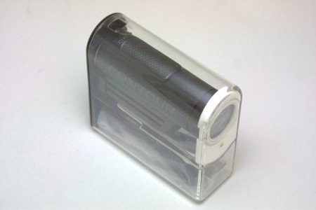

The Contour ROAM comes in a hefty black box. The bullet cam is encased in a plastic case. The package gives off a sense of quality. After opening the package, you'll see that Contour provided you a nice protective case for the ROAM. It's transparent and works as a high quality display case to show off. Unfortunately, you won't be able to use the lens cap with the display case. A separate compartment in the display case allows you to store USB cable and other goodies.
