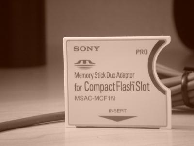

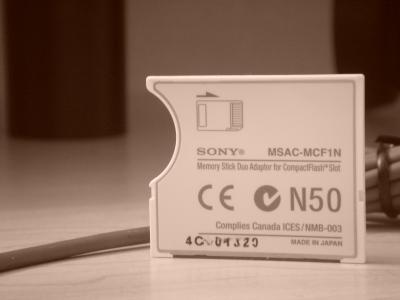

The Sony MSAC-MCF1N Memory Stick Duo Adapter for CompactFlash Slot is a CompactFlash Type I adapter that accepts a Memory Stick Duo in its body. A curved slot on the adapter's side allows you to insert a PRO, MagicGate, or a basic Memory Stick Duo storage card into it. The adapter turns the inserted Duo card into a CompactFlash for you to insert into a CompactFlash digital camera, PDA, or a memory card reader/writer.
The MSAC-MCF1N is difficult to find at your stores and it is out of stock everywhere online. It turned out that Sony is simply restricting its sales (see my "Shortage everywhere! Sony MSAC-MCF1N Memory Stick Duo Adaptor for CompactFlash Slot" article in the Related Links section). When I did receive one, it came in a clear plastic blister pack with Sony's design all over it. Inside the blister pack is the adapter itself, a CompactFlash sleeve to protect the adapter, and two instruction manuals.

Interface: PCMCIA / ATA interface compatible with CompactFlash Type I slot
Operating Voltage: 3.3 / 5.0 V
Power Consumption: Max. 70 mA
External dimensions: Approx.
42.8 x 36.4 x 3.3 mm
1-11/16 x 1-7/10 x 1/8 in.
Weight: Approx. 7 g (0.25 oz)
Operating Environment: 0 - 60 degrees C (no condensation)
