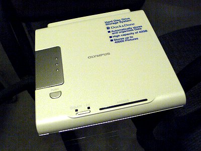

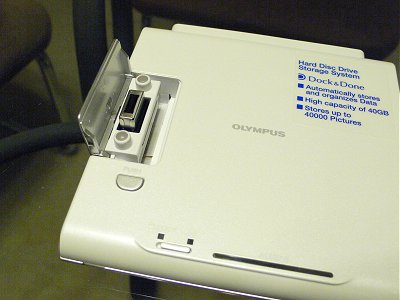

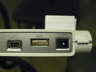

The Olympus S-HD-100 is manufactured as a slim white case with silver sparkles. It has futuristic design ques that is pleasant to the eyes. The external casing is robust and sturdy. There is an "on" indicator LED in the front, but the actual on/off switch is in the back, designated with a '0' and an '1'. A mode switch on top allows toggling between "DOCK" mode and "PC" mode. A long ACCESS indicator LED resides beside the mode switch. A silver push button reveals the "Dock&Done" port under a silver cover. Four ports are in the rear of the unit: "Dock&Done" printer port, mini-B USB port, standard USB port, and power port.
The mini-B USB port allows the S-HD-100 to connect to the computer. When the mode switch is set to "PC", it act as a mass storage device (or a removable drive). It this mode, the S-HD-100 also acts as an USB hub; USB devices could be plugged into the standard USB port on the back of the S-HD-100. Thus, the S-HD-100 wouldn't take up all of the USB ports on your computer if it only had one. There is a warning in the instruction manual for the standard USB port: "you cannot use VBUS-based devices because the power supply via VBUS is not supported". I have no idea what a VBUS-device is. The USB memory card reader I plugged into it seems to work fine.

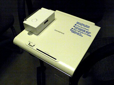

The PA7 adapter is a small white box, about twice the height of a matchbox and twice as long. It has a "COPY" button on top and a standard USB port on the right. Before getting the adapter, I had wondered how it interfaces with the S-HD-100. Did it connect to the USB port on the S-HD-100 and act as an USB bridge? It turned out that the PA7 adapter interfaces to the S-HD-100 "Dock&Done" port.
To use the PA7 adapter with your S-HD-100 and your digital camera, all you have to do is attach the PA7 to the "Dock&Done" port on top of the Olympus S-HD-100 Hard Disc Drive Storage System, switch the mode switch to "DOCK", connect your digital camera to the USB port on the PA7 adapter, turn on the S-HD-100, turn on your digital camera, and push the "COPY" button. If your digital camera is compatible with the S-HD-100 and the PA7 adapter, the adapter will automatically copy all of the images in your digital camera to the S-HD-100. The blue "ACCESS" light will start blinking slowly.
