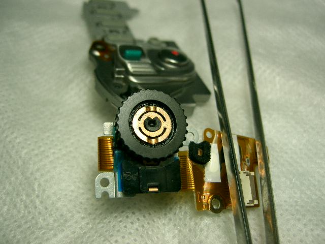

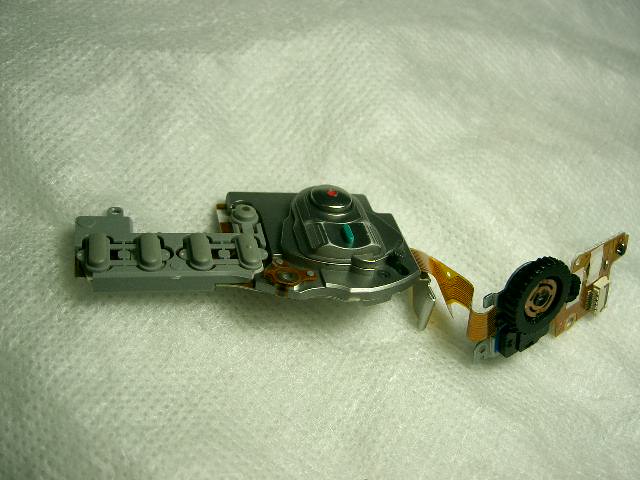

Sony DCR-PC110 select button cann't work
Sony DCR-PC110 select button cann't work, I cann't adj or set any function,
is there any one can teach me to slove the problem?

What's the photo of? Is the photo of the select button that you are talking about?
Sun, 24 Jun 2007 12:11:51 -0700
Hi Chieh Cheng,
Yes, the photo is the select button that I am talking about.
Jason
Tue, 26 Jun 2007 07:26:58 -0700
I think the first thing to try is to use a digital multimeter on it to test the pins for the switch. With the digital multimeter, you can determine whether the electrical path changes when you rotate or press the switch.
Another thing you can do is to pick up a spare part. Put it into your camcorder to see if the problem persists. If so, it's probably not that part, but rather the circuit board inside your camcorder.
