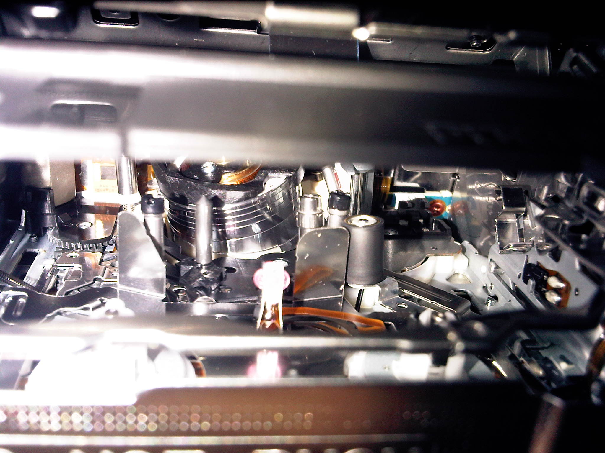

it's solved just see the pics
I have the Error c:32:23 and C:31:22
I reviewed almost all the comments tall about smacking the camera it's sound a mechanical problem, this why I try to check the Mechanics as u can see In Pictures attached the back Rubber wheel is not in the proper place and the white plastic lock is not there when I flipped the camera upside down it's come out (the white plastic lock) then I place it BACK so the error is gone that grate no more C:32:23
I wish this will help others
Regards
Ahmed Jasim
Iraq
Ahmed Jasim

HI ahmed.
Im getting error C:31:22 and when i opened the camera, the little "white plastic lock" you mentioned fell out. It is not clear from your post where it needs to go back. Can you give a little more advice for this techno-noob. Thanks!

I had suffered from C31:23 problem for 2 years with my DCR TRV740 and pay more than 200$ in a certified service center no body was able to give help. Finally, a couple of months ago I decided to disassemble my camcorder, I found a small rubber roller stick to the video head. Succefuly , I allocated the right axis where this rubber roller should fit. It could be seen when the cartridge cover is opened (without disassembling the unit). Actually, it is a moveable axis (you can push it to slide with your finger). The role of the roller is to pull the tape and stick it to the video head.
Joyfully, the camcorder worked but the roller could slip out of the axis without a Proper Lock to fix it on its place. This is the defect of SONY design they manufactured a small tiny ring to hold the rubber roller on the axis, after 1-2 years of operation this tiny ring would break which cause the error C31:23, what I did is I fetch in my box of small hardware part for a small plastic ring with a one millimeter cylinder in its middle to fit around the axis and the I use "Patex" glue to fix it on the top of the axis to prevent the roller of moving out.

Am really happy to see my self helped to make all this number of people feel happy to fix their hand cam thanks for all nice comments
Please find the picture below to clear any ambiguity regarding the roller wheel placement

I'm getting the same error messages. I also noticed that the black rubber roller was off of its spindle. I have't secired it with a plastic lock, yet. However, I'm testing it with the camera on its side, so that the roller will not come off. I kow I need to secure it.
I'm also resetting the white tab from the lock position on the spindle that "drives" the tape wheel that collects or winds up the tape.

I have a Sony DCR-TRV340 and was getting message C:31:23. The rubber wheel had fallen inside the cam. I placed it back to its position and my cam is working fine. However I could not find the white plastic lock. I may have to contact sony for this.

I've concluded that sony dealers don't have the white lock in their stocks as a spare part. you have to make one by yourself.
The diameter of the spindle axes is exactly one millimeter. you should find a copper tube of 1 millimeter inner dimmension (from a hardware store) cut a 3-4 mm of it (usually it comes in 1 meter long) use a mini disc drill to cut it, do not use a cutter because it will deform the tube. if you find the made lock loose and do not grip around the spindle then you should enter a tailoring needle in the made lock then poor a little bit of "patex" cement on its extreme and pull it out again. now the patex glue should fill the made lock. push the lock into its supposed position. use it the next day.
N.B: you don't have to disassemble the camera, just disassemble the door plastic cover

The pinch roller is the problem. I removed the white plastic piece which was cracked and replaced it with a similar sized piece cut from the end of an ink refill and voila the camera works like new. Thanks for the pictures.

The black rubber wheel was of the spindle and was laying inside the camcorder. I did not find white cap but I will try to make of something .

Thank you very much to Ahmed Jasim. I had that 31:22 error and after looking at your pictures and the diagram, I looked at the white cap and saw it was out by just a little bit. I pushed it back in and it was fixed. I thought I was going to have to spend a ton of money to get it fixed.
Thanks again and be safe my friend and I hope everything goes well in your country.

Thanks Ahmed and Jason, for your analysis of the problem and the illustrated instructions.
I had been having Error messages off and on for some time, which I usually solved by taking out the cassette and whacking it against a flat surface (an old trick from using audio cassette recorders). This time, after not using my PC9 Handycam for a month and a half, nothing seemed to work.
After studying Jason's pictures and peering into my machine, I figured I was missing not only the white plastic part but also the black rubber part. I shook the unit a whole lot with the door open and the white part appeared against the red table cloth. It was so small I might not have noticed it had it not been for the pictures. Encouraged, I continued to shake a whole lot more, but nothing else appeared. Dismayed, I went and sat down on the living room rug in front of the TV where I had been hoping to watch the videos of my summer vacation. And lo and behold, by some miracle I spotted the rubber roller in the nap of the rug.
Not having any proper tools at my current location, I used wooden matchsticks held by a clothespin and a kitchen knife to put the rubber roller and the pin over the spindle and a kitchen knife to tamp them down. I'm in business again.
The advice of another contributor, to always check the status of the white holding pin when changing tapes, is probably very good. And our general opinion that Sony could treat its customers better is very true.

Add my thanks to Ahmed Jasmin! I found the roller inside my Sony TRV-350 and re-seated it as Jasmin suggested. All Better! Rather than a plastic tube from a ball point pen for the lock, I used a small piece of rubber tubing from an eyeglass repair kit. thanks again, Jasmin,

Ahmed, You are the best! Your pictures helped me fix my video camera. From the looks of it, you have helped so many people with this one that you don't need to do another good thing in your life.
Thanks, Scott

Thank you so much all of you. I tried the banging, smashing it seemed to work, but only for a few seconds.
When i banged it without a tape the black rubber wheel came off.
My white plastic must have fallen off earlier.
I took a peace of electrical wire insulation, that was the right size.
Now it works fine.

Thank you very much Ahmed Jasim ! I had that C:31:23 error on my PC 101E. I had found that weird litte roller but couldn't figure aout how it was supposed to be fixed (the white part had fallen porbably lost... I took the WD40 spray tube and it is working properly now !
Thank again for the pics.

Ahmed's post 09/01/2007 has fixed C:31:23 for me - my black roller was missing completely when I looked. It was tucked away at the back of the camera with the white "locking" tube still in it. I managed to shake the two out and re-assemble with tweezers in 1 minute. Brilliant advise!

Can I just say THANK YOU Ahmed and all of you who put comments about these parts falling out. I just spent a total of 12 minutes taking the three screws out of the top plastic cover of my DCR-TRV350.
AND THERE IT WAS!!!!! Staring right at me!!!!! That little rubber barrel piece wedged in the corner. I spent HOURS of time with Sony on the phone and searching the internet for a way to get our camcorder "fixed". We just came home tonight from comparing new camcorders as we are tired of missing so much of our kids activities and an upcoming vacation. Stupid frugal me, I was having a hard time departing with a pen to use a tiny piece of the ink tube. Then I compared the costs of the parts and repair charges,( about $100-$200), to the fraction of the piece of pen that I was about to destroy, I realized that IF this worked the memories wil be priceless!!!! As I wipe the tears and say a prayer of thanks and God Bless to you all, I'm going to record my family while they sleep,as they have no idea of our huge accomplishment.

For me, Ahmed's solution worked. I looked in the cassette compartment (with the tape out) and found the black roller wedged behind (above) the record head. It took a little shaking to get it loose. I couldn't find the smaller locking tube. That obviously fell out on top of Lookout Mountain when I opened the camera to see if swapping tapes would solve the problem. At least I know where to go to look for it. Well . . . not really. I am glad that the roller stayed with the camera!
I replaced the locking tube with a short piece of a ball point pen tube and the camera works fine now. I had to crimp the tube some in order for it to grip the roller shaft so a piece of tube with a smaller inside diameter is called for. I do plan to carry this ball point pen and a pair of needle nose pliers in my camera bag now for field repairs.
Ahmed, thank you for an excellent solution. No telling how much money you have saved me. Karma will reward you!

Response: I don't recommend a copper tube, for several reasons:
1) in order to cut it you're gonna have to use a Dremel and a cutting disk or something, which will cause abrasions on the end of the copper tube. And, the Rubber Black Roller (the capstan pinch roller) is made of plastic down inside. As the black roller spins it will come up against the copper tube and run against it like a lathe running on a piece of material. It will slowly (or not so slowly) etch away the inside of the pinch roller, right where it slides down on the shaft, ultimately eating it away.
2) You'd have a very hard time getting a copper piece of tubing to slide down on the shaft, without pushing down very hard. And, if you push down hard, you'll bend the arm that hang out blindly into the air, that has the shaft and black roller on it. Then the black roller will sit at an angle.
Definitely use a tight fitting piece of plastic tubing (like the ink pen tube that many have talked about).
I ordered the piece from Sony Parts (about $10, and about $10 in shipping....$22 total), which included the entire arm, black roller, and plastic retainer. Of course, all I need was the plastic retainer. I would like to note that the new "white plastic retainer ring" is actually gray plastic now. I'm betting that Sony went to a different type of plastic to get it to stay on better now.
Finally: When the new assembly arrived, I took it apart piece by piece in order to use the new "gray plastic retainer" inside my camera. I was surprised to see that there are two subminiature nylon disks one immediately below the black roller, between it and the metal shaft inside the camera. And, another between the black roller and the white/gray plastic clip. And, these had a minuscule amount of white lithium grease on them to lubricate them.
I would recommend having these nylon disks in the assembly and the tiny bit of white lithium grease. Because, they allow for a slip-surface between the black roller and the shaft, and between the black roller and the white/gray tube looking retainer.
I dropped my camera on the floor (that would be much like the "banging" recommendations that many have made here online). And, seconds later my son said, "Dad, what is that?" Laying on the floor was my black roller. The impact had caused the white clip to come off the shaft, and the black roller to come out of the camera.
I do not know if the two tiny nylon washers were ever inside the camera originally. OR, whether Sony started including them on the replacement assembly to make it operate better.
But, I'm relaying all this info to all of you, to say, "Please don't BANG your camera". There are many delicate mechanisms inside camcorders: black roller, white retainer clip, tape alignment rollers, the flying record/playback heads, tape load and extract mechanisms with tiny plastic teeth.....and oh my goodness, very delicate optical mechanisms on the lense...whether you have optical stabilization or digital image stabilization) - banging is not a good idea! Banging should never be a solution. And, in my case, the medium bang it got when it fell off my computer desk onto the floor, was just the bang it needed to make that black roller and white retainer tube simply come off!!!!
