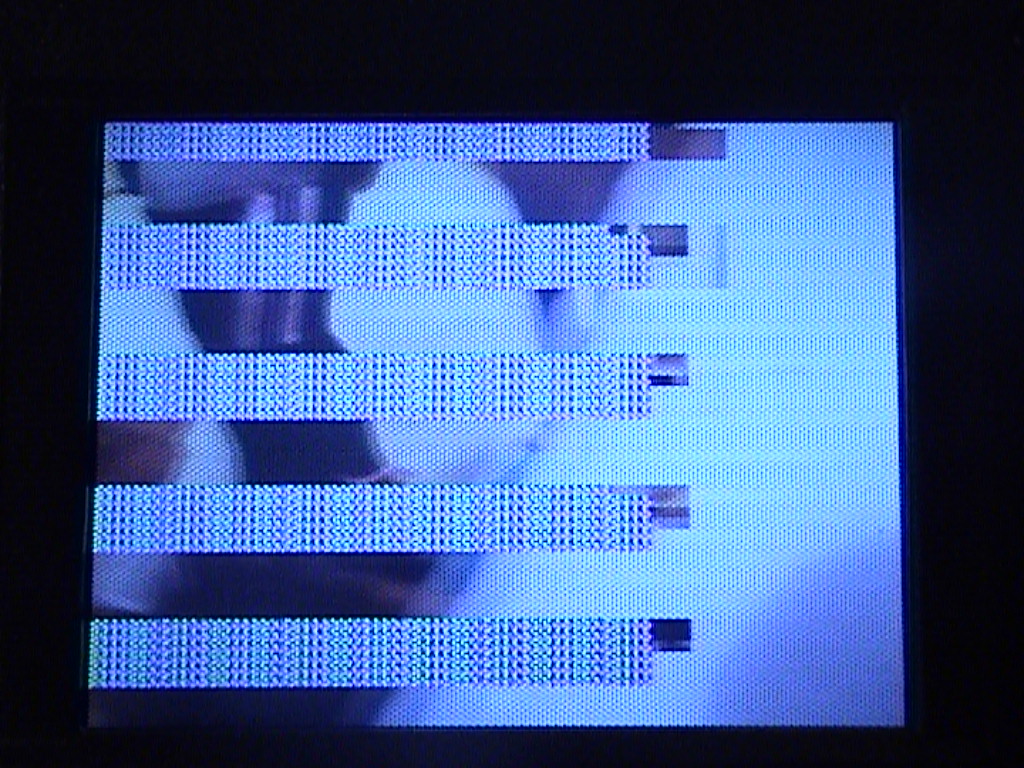

I have a DCR TRV 120, and I just recently found that smacking the thing fixes the whole C;21:23 code thing. Now that it works, when i try to watch the video from te tape or upload it onto my computer. it shows all of the right side of the screen, but the left side has horizontal lines of just colors, and blocks the video that is supposed to be there. This is happening with all my tapes, and I am pretty sure the tapes aren't bad. It also won't upload any video onto the computer while its like this.
Any help would be great. Thanks

I have the Sony DCR-TR7000E which looks similar to the TRV120 but has no LCD screen. I had the problem of 3 broad horizontal lines across the screen several times and the cause were contact problems on one of the flat cables inside which I moved (after carefully opening the left side of the cam) or pulled out and pushed them back in again. That always solved it but I know that opening it is a very delicate thing and should be done if you have some experience with such gadgets. Your problem might have the same cause. It would be worth trying. Sony charges fixed amounts even for such simple repairs.
