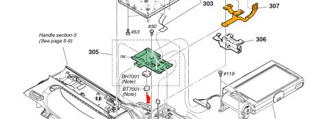

Located under the control panel. part # is 1-756-134-12 for more info., contact http://www.myksvc.com

If you can fit one of these then you can easily do "Brain Surgery"....Best of luck.
