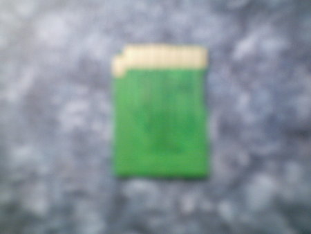

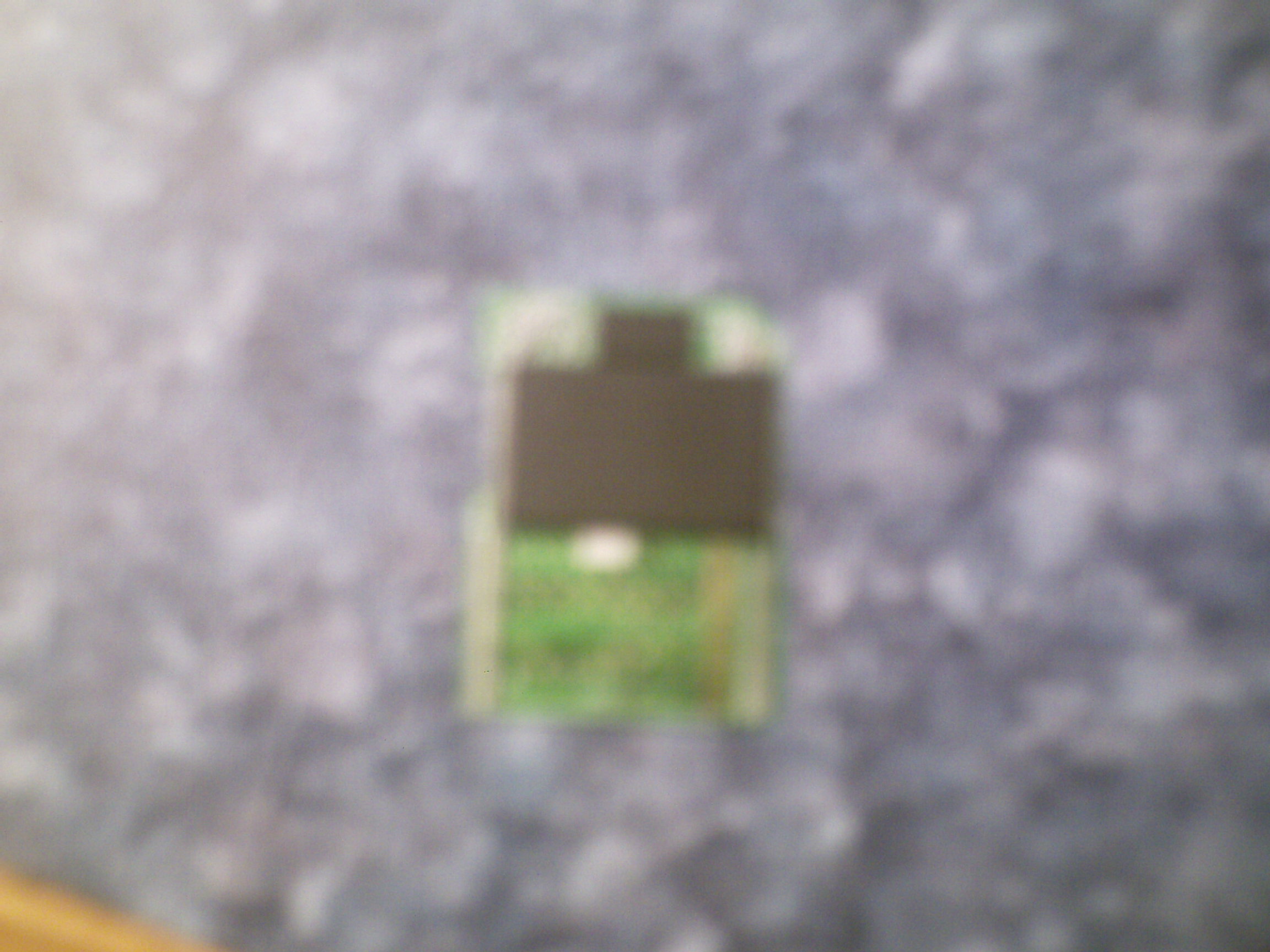

i have the same kind of problem with the sd card being locked, only my sd card has no plastic cover, and no card protect switch to lock and unlock it. I tried using electrical tape and aluminum foil, which worked for a day or two and then didn't work. I was wondering, Is it possible to fix this problem?
(see attached pictures)

Wed, 07 Nov 2007 17:31:46 +0000
(see attached picture)

Haha. What happened to the plastic case on your SD Card? As you can see from the "Tape Over Notch on SD Card.jpg" photo above, the lock is purely physical. Without the case, it'd be very difficult for the card to trigger the lock sensor. You'll have to make a lock tab that is extended further out to the edge of the plastic case. To do that, you'll need to compare this naked card to a cased SD Card.
Wed, 07 Nov 2007 17:35:45 +0000
well, it had started to break apart about 3 months after I got it. it had been fine up until about the second week of september, then it just broke, I managed to fix it with electrical tape, but the second I put the fixed sd card into the camera it worked but when I went to take it out, it wouldn't come out. so I took the camera apart and pushed it out, that's when the whole thing fell apart.
oh, and I still have the intact case. It split along the seam where the retards who put it together glued it.
is it possible to somehow trick the lock sensor without making something for the sd card? and is it possible to somehow remove or modify the lock sensor in my camera? just wondering.
Brenden
Wed, 07 Nov 2007 17:46:48 +0000
The sensor is either an optical sensor or a mechanical sensor. Based on the tape trick, I'd assume it's a mechanical sensor. You can probably disable (or permanently enable it) by pushing the mechanical sensor in and hold it there . . . maybe with solder? or tape?

My tab snapped off (I remember it happening at the time but I didn't know what it was). I tried sticking selloptape over the gap but it didn't work. So opened the memory card I got an old credit card and cut a small piece the size of the tab and put it at the bottom of the gap. Then I sellotaped it back. It worked!!!
I had to take it out again and make it a bit neater because the card got a bit wedged in my camera :0
Kim

My SD Card toshiba &scn disk is locked and the little switch is broken. iam a electronic tec.
why this problem rectified i open the cover and removed pcb
