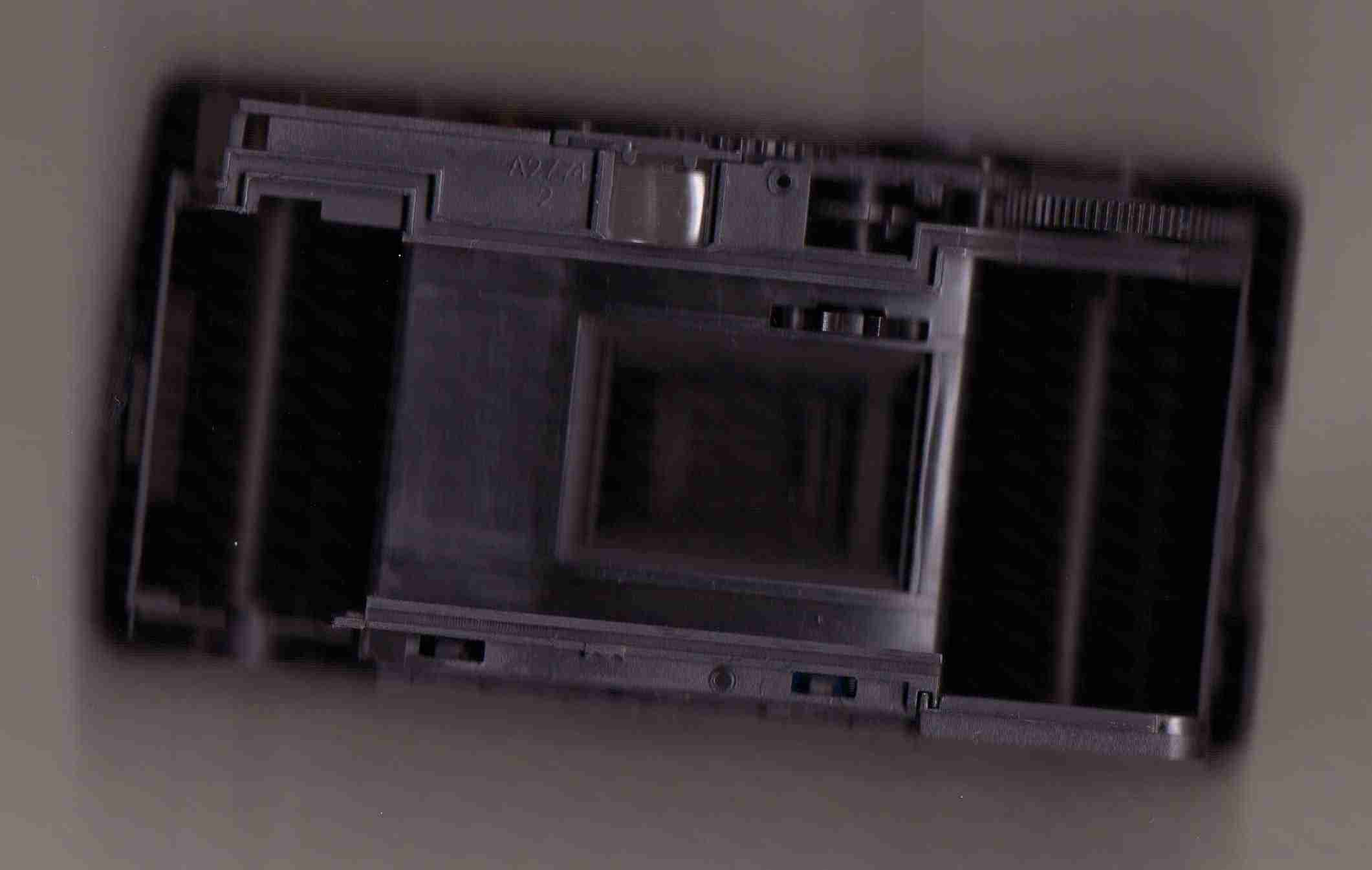

I have never worked with a LeClic disposable camera before. But I think if you follow along with my article, you will have an idea how to get started on pulling it apart. Don't operate on the one you just finish shooting, since you probably don't want to lose any pictures. Buy a new one and operate on that. Once you figure it out, then pull the one you shot apart.
Good luck.

To refill the Kodak Camera's without going through the hassles of darkrooms etc, follow your instructions until you get to winding the film, if you look at the front just under the shutter, you will find Two holes, You need to stuck something round into both the holes which will disengage the Mechanism allowing you to snap the camera back together, and wind away anywhere.
As another note, the Agfa "LeBox" camera's are far simpler to modify as they are all standard, you will need to make a jig to wind the film back using rubber to drive the inside of the wind spool.

The film are wound back into the film cartridge as you shoot. Everytime you rotate the film advance wheel, a frame is stored into the film roll. So when you are done, the entire negative is in the cannister.

Yes you can reload most disposable cameras. One thing you have to remember, each time you take a photo it winds into the cassette, so it starts outside the protective case in the disposable camera. You need a dark box or dark room to load them. Practice in the light with your eyes closed to get the idea. Any light with 4oo iso or higher with cause film fogging. I've loaded most of them, the waterproof ones are the most fun.
