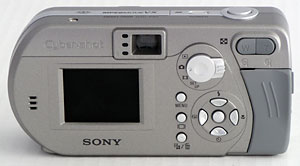

Hi.
I was given a Sony 5.0 P92 camera as it was not working.
When i press on the Power. It comes on with a green light and then goes off. The zoom seems to be stuck. LCD will not come on.
Is this camera no good or can Sony fix this. Will it be worth to fix the camera or to buy one. Live in Canada.

The problem is with two gears inside the camera. One small plastic gear has to turn and while involved with a bigger gear (5 to one ratio) it pushes the lens out.
The main problem is that the gears get stuck and the smaller one can not turn the bigger one since gears on teeth to teeth.
This is the reason why so many people, including myself, have been able to resolve the issue temporarily, by tapping on it.
