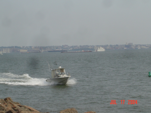

I attach a VGA sized picture taken with zoom yesterday. You can see a spot to the left of the boat in the picture, and there are discolorations in the sky.
Attached File: DSC06529.JPG

Seeing the picture and video that you have provides, it looks like a common dust problem of digital SLR's. On digital SLS's the sensor is not sealed off as tightly to the environment, due to interchangeable lenses, as digital point-n-shoot (P&S) cameras. Thus, the dusts gathered on the sensor surface show up when the aperture is closed-down to its smallest opening.
You can see that easily when you paned the camera in your video. In dark areas, the aperture is opened wide and no spots. But when the camera moves into a brighter scene, the aperture closes, increasing depth-of-field, and the spots showed up.
I'm actually quite surprised that dusts got on the sensor in a tightly sealed P&S camera. Have you opened it before? If you have, and you are comfortable with opening it again, you can try cleaning the dust off the sensor yourself. If you have never opened it before or dare to try, your other option is to send it back to manufacturer for service.
