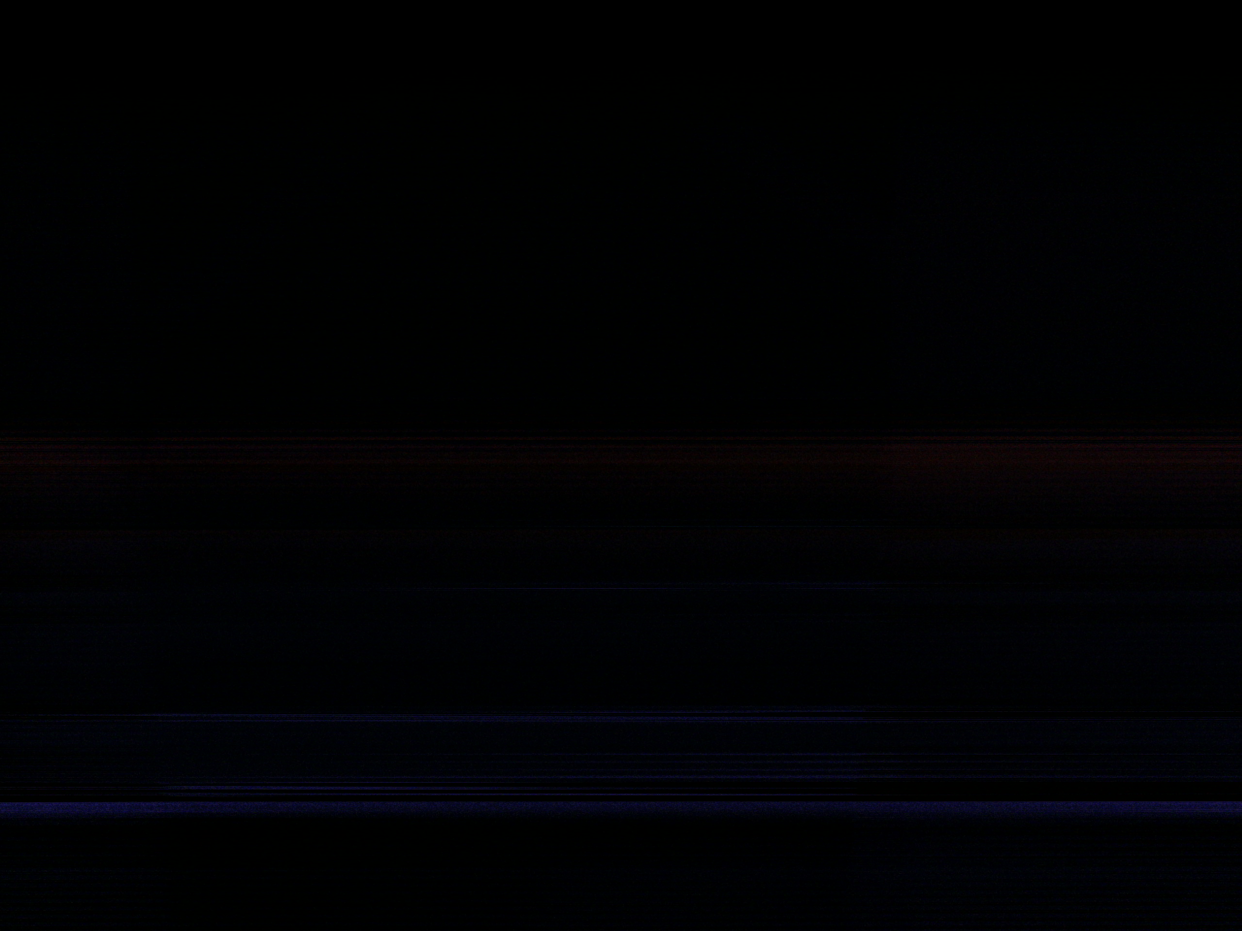

i have a problem with my 717. both viewfinder and screen show a green picture although it is not set on nightshot or nightframing. but the pictures come out fine. is this problem related to the problem you are discribing ? i have checked everything, changed all settings back and forth, but no change. everything showes in green tones but comes out fine.

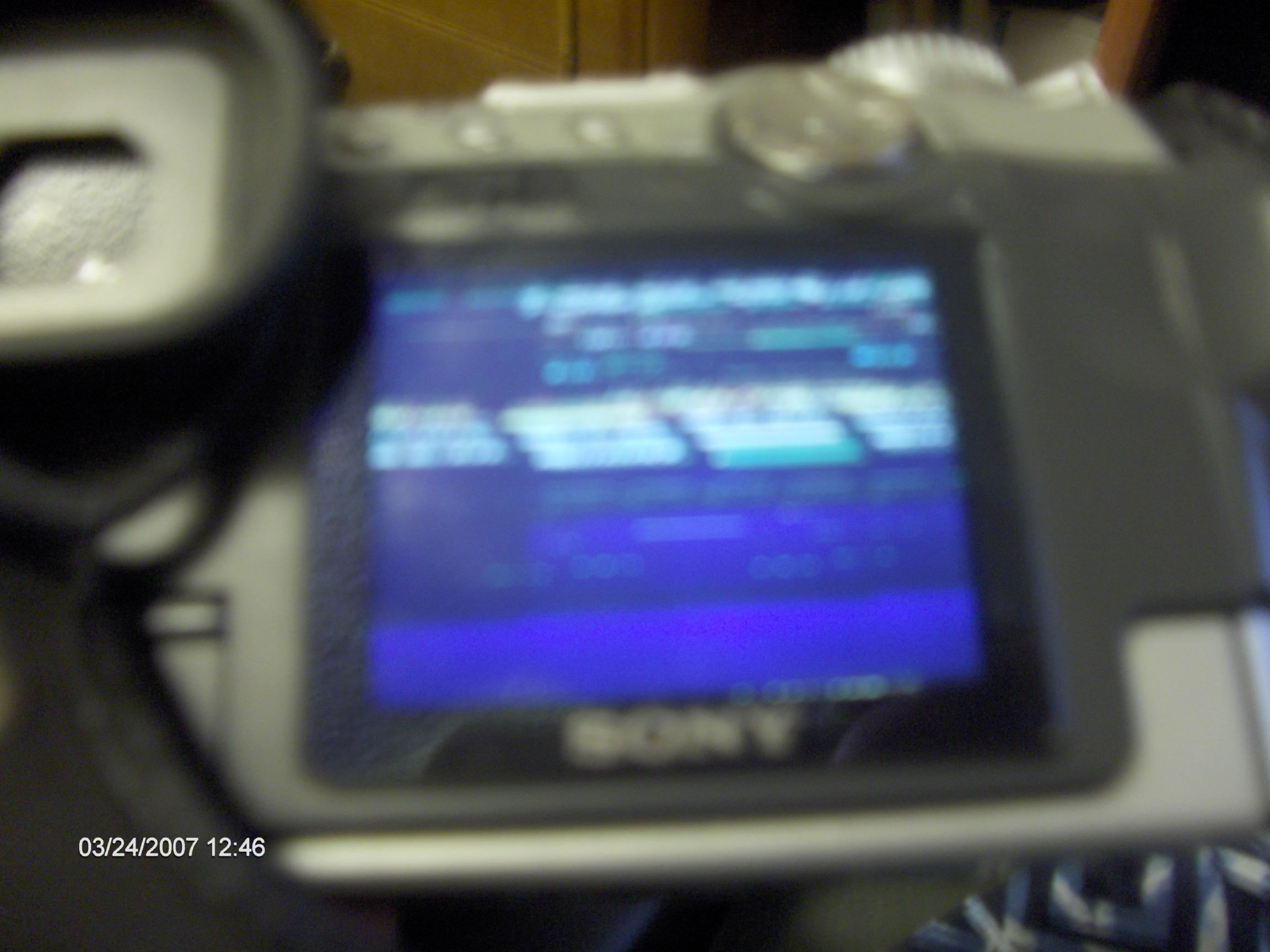

um had similar problem but my distortions are white scan lines across my viewfinder, i called and after getting fustrated with the person she had me try to reset it and my screen went black but the fadded purple pink and purple lines are horisontal she requested thet i get it looked at so i guess i'll send mine off as well hope fully it won't be a horror story seeing as my extended warenty expired 10 days ago
added some preview images..

Hi all,
This site is what I was just looking for.
My camera hasn't been working for 6 months now. I didnt know Sony had a recall.
But not sure if camera can be repaired for free. The Image isnt the same as in Sony website its not even close.
I get about the same image on the LCD and also the view finder.
Here is a pic of the image I get on the camera. Please let me know if this can be fixed for free or not.
Many Thanks,
John
John Croes
Fri, 23 Mar 2007 21:46:54 -0800
Here is another pic. Kinda hard to take these pics.
John
Fri, 23 Mar 2007 21:48:12 -0800

hi i have a Sony Dsc-f717 and have the overly white flushed out photo syndrome. i have changed the battery and memory card and still the same. in video mode it works fine. i know you guys may not be experts but does it sound like the CCD problem to you and thus make me eligible for free repair. before finding this site i had emailed sony and they said it was 115 pounds to repair digital cameras and fifty pounds for beyond economial repair cost and gave me this blurb about checking night mode etc,etc-they didnt mention it was a common problem- think this is very deceitful of them. anyway enough talk, my question does it sound like i have the CCD problem??
Wed, 02 May 2007 10:35:48 -0700
oops thought i better show an example of the photo. on the viewfinder,its ok until you take the photo and then it goes superwhite. didnt realise there were lines until i transferred the photo to the computer for this. anyway does it look like a ccd problem?
Wed, 02 May 2007 10:55:33 -0700
Thu, 03 May 2007 05:49:06 -0700

My F717 has been doing the same thing. Oddly, the problem seems to *Come & Go*.
Sometimes it works fine. I just sent in the online repair request form, taken from the site linked here.
I will post back, and let you know how my repair experience went with Sony. Luckily, I have a back-up camera, but I have always loved my F717. I own many Sony products, as I have always had good experiences with them. Never had a problem with any of their other products. Camcorder, 2 TV's including a high-end HDTV... all perform perfectly. I can only hope Sony will stand behind my Camera.
I have attached one of the photos taken when this issue was present. Let me know if any of you other owners had a similar image.

I have a slightly different problem with mine. The screen works but is covered with white stripes after a photo is taken. When I turn it off and on, it usually works. Any thoughts?

Just had my F717 go bad. Went to http://esupport.sony.com/US/perl/news-item.pl?mdl=DSCF717&ne . . . and the site says "Until September 30, 2009." It also costs $20 now. Whatever, it's better than a new camera!

I was experiencing problems with my lcd and finder, but the taken pictures where still perfect.
The lcd and finder colours where blurred and not arranged properly.
Put a bag of desiccant into a plasticbag with my camera and wrapped it tightly.
After a day everything is perfect again. It was a problem with humidity in my camera.
Love my camera again. Hope to help anyone with the same problem, since the guarantee and the support from sony ran out.
Cheers!

In Germany sony still seem to repair the lcd!
http://support.sony-europe.com/dime/hotnews/hotnews.aspx?sit . . .

I have had the same issue but with the blury screen. Thank you for the link as I was going to trash my camera as it is unusable. The Sony link says the cost is $20 and the offer expires Nov 30 2009.
thanks again folks this was a big money saver!

Just called Sony and they are repairing mine FOC other than the 20.00 S&H fee. This is the second one that I've had to have repaired. Other one was repaired a couple years back. Can't fault them for service and repair. If you look on the Sony site says it is out of warranty, but a phone call soon shows that they'll make good on the product.

The recall has been extended to March 31st 2010
I got mine back today all fixed up!!!
