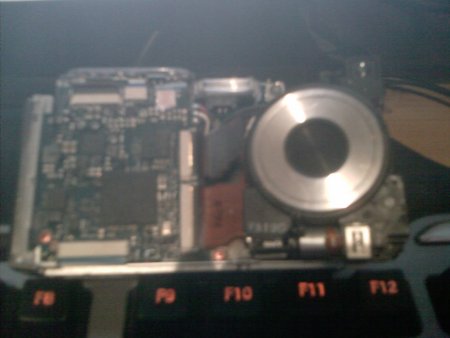

I had this problem, and bought a repair manual off ebay for a few pounds... the way i fixed it for my W-80 was remove the front cover (4 screws), remove the ribbon cable x2 connecting the lens to the PCB, clean the contacts of the ribbon cable, reconnect them; and boom, done :D
the hitting/tapping must temporarily fix it by vibrating the ribbon cable inside.
hope this helps, if you're good at taking things apart (don't try if you're not!)

Thu, 04 Feb 2010 17:35:25 +0000
ok so i had the same problem as everyone else,
after my friend dropped her camera, it came up with the same error code,
and could not focus or zoom at all.
so what did i do? i carefully took the camera apart, by taking out the 6 screws on the outer case, then gently pulled the front cover off. after you have the cover off, you will see the lens/sensor assembly. from what i gather, there are two stepper motors, one for zoom, one for focus, the focus one was playing up on this camera, it was jammed.
so what i did was unclipped the two ribbon cables going to the lens/sensor assembly, and gently removed it from the camera, and undid the two screws holding in each motor, and rotated the motors, the focus motor in particular, with some pliers, until it became unjammed. then put it all back together, and presto, it works fine.
you must remember, the ribbon cables will tear and break if you are not gentle with them, be VERY carefull with them, especially the ones on the motors, and the ones connecting the lens/sensor module to the rest of the camera.
i expect this problem will happen again, probably a design flaw. i dont know where to get these motors from, nor do i know why they are so sensitive to shock.
cameron20020
Mon, 15 Feb 2010 05:56:55 +0000
Not really sure if people read this any more but the error code's are normally related to the ribbon cables coming lose inside (bad connectors). In this case the brown cable pleas let me no how you get on
Clive
Sun, 14 Mar 2010 19:59:32 +0000
Oh i forgot to mention what was going on basically the top ribbon cable is what transfers the photo to the circuit bored and the brown cable connects the circuit board to the focus motor and shutter on the camera and lens

I've had this error on my T10, took the battery out and reinserted it, gave it a thump, and who would have thought? It works perfectly!!!
Rajeshwar
Mon, 09 May 2011 19:14:14 +0000
I have a Sony T10 that was working just fine and then started flashing E:62:10 in the display. It seemed a little slow starting up but took pictures just fine.
I consulted the manual and re-initialized the camera - this resulted in no change.
So, I took the camera apart to check ribbon cables - no change.
Then I took the cable and hooked the camera up to my computer and looked at the photos - something odd had happened, the camera had started saving pictures on the other side of my card petition. i.e. I had file 101 for photos and 102 for recordings and the camera started saving photos in 102.
So if you get E:62:10 and everything seems to be working - save the pictures from your storage card and reformat it - It just might work.

Fri, 12 Apr 2013 18:12:41 +0400
I have a DSC-T30 and after many years of trouble-free operation the E:62:10 error code suddenly appeared today.
None of the above mentioned remedies except one served to alleviate the problem: just a bit up-thread someone mentioned cleaning the battery leads themselves.
What I did was to simply switch to my second battery and the problem immediately disappeared. It clearly has something to do with the battery leads and simply oxidation or dust.
The reason hitting the battery side of the camera seems to work is that through the vibration enough contact is re-established for normal operation to be resumed.
So, first thing is to carefully clean the battery contacts. No need to hit your camera.
