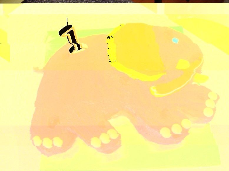

My DSC92 has developed this problem and it’s definitely the camera. The attached pic looks just the same on the LCD. I'm less than impressed with this camera; it's heavy, takes forever to capture a picture and eats batteries.
Any idea if this can be fixed and how much it would cost? If it's even half the cost of a new camera I’ll be giving this one the bung.
