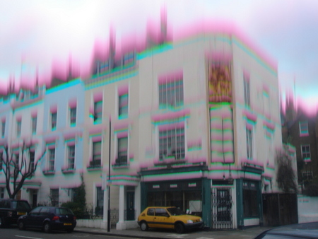

Blurry pictures please help Sony Cybershot DSC-T7
Everything has been reset to default setup again -manually, unless somebody know how to find this button/menu setup somehow.
Never had any problems, it somewhat started spontaneously.
Pictures became blurry, I had cleaned the lens, and was not shaking around when I took all the pictures.
Never been dropped, took really good care of it.
Nobody can seem to help at repairs, and Sony takes a long time to get back to you.
Does anybody here seem to know whats going on?
I will attach one of the pics here.
Marguerite
Sat, 14 Jul 2007 18:20:33 -0500
Your CCD is bad, there is a recall but the T7 isnt covered... you can call up Sony and try begging and see what happens or look for a defective camera on eBay with a good CCD you can switch out.
