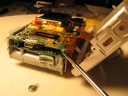

A friend gave me a HP 635 she didnt want anymore kept running down the batteries.You couldnt even take 2 or 3 pic's they would be dead. I did alot of goggling then decided to try what found out and now I have a feebie that dosnt eat batteries and take's a nice picture.
They have a bad capacitor the keeps the time when you change batteries.They go bad and start draning batteries. Well take it out you have reset the time when changeing them seems to be the only trouble it causes and now I can take a few 100 pics. Just look for the small silver capacitor looks like a watch battery I just cut little strips and left them apart and coverd with silicon.
Tim
Thu, 21 Dec 2006 10:30:30 -0800
Oh yea The picture is the part I took out.

I have the same camera
the guy who sold it to me said it was a christmas present but as they unpacked the box, put in the battery, 10 photos and battery gone empty.
I bought it with a cheap price, thought, 2500 mAh ni-cd will help but no luck, same problem. I also tried FIRMWARE update. no luck, same problem.
then I found this site. COOL!!! I like hacking :))
I am thinking of removing the capacitor too. anyone tried? what will I loose ? it will only forgot the date and time?
that would be OK for me. BUT if it also forgets the settings: FLASH, etc, then I will be sad :(
I am trying to ask an independent camera service guy to REPLACE the capacitor. if no chance then fuck, remove it I dont care. the camera is a good 2,1 megapixel camera! fast and handy!

so, I dis-assembled my camera, removed the "capacitor" and everything is OK now!
and, when I replace the batteries relatively fast, the camera does not even forgets the settings! (time, date, etc) now I can take with a 2500mAh recgargeable battery 100-200 shots or more.
how did I removed the capacitor? (shown at the pic I attached, te small thing which looks like a watch battery)
1. : I removed the screws: 2 at the right side, 2 at the left, 3 from the bottom + the small screw behind the battery-compartment door, I popped the cover, removed a longer screw to remove the back (caution, it is wired to the body) .. I do not remember there were any more screws... tip: put a kitchen plate under when you remove the screws, you will hear when you drop someting) (do not forget to put back the battery door ant the cover of the USB afterwards :) )
2. :and, as Tim wrote, I looked for the capacitor on the circuit boards. I DO NOT REMOVED the upper circuit board, I do not wanted to do this! it was so heavy attached: with data-cables, screws, it was even fixed with a strong, transparent adhesive tape.
I looked BETWEEN the circuit boards, and I got lucky: I FOUND the CAPACITOR. LOOK WHERE THE SCREWDRIVER POINTS on the photo!!!
I did the following: I BROKE THE CAPACITOR OFF the circuit board, with a help of a tweezers. look at the pic: the capacitor has CONNECTORS fixed to the capacitor and this connectors are soldered to the circuit board. I moved the capacitor with a tweezer UP AND DOWN and lightly to left and right (take care do not brake any part out of the circuit board, try just to break the soldering)
thats all.
cheers, Martin from Hungary (Europe)
martin
Wed, 21 Feb 2007 03:46:46 -0800
I am sorry..
removing that part I mentioned did not helped. I guess there are not only one capacitors, OR I really have to totally dis-assemble the two motherboards to see clearly.
sorry :(

so, as I posted on this camerahacker site in my second post: I was unable to fix that camera, it still functions, but it still drains batteries :(
as I removed the cover, I found, that the two printed-circuit boards are fixed together with a yellow self-adhesive film, kind of a strong glue-type! I got scared that I damage the thin, foil-covered copper wirings, which go from one board to another because the glue-tape was on them also (check the picture on the site)
So, I got a little angry because the camera was ment for my mother (2,1 mpix is enough there..) and I could not fix it. but, it was a cheap buy so I looked and looked again and found a "capacitor-like" element (after google-ing like you) which I decided to remove. I could not remove by molding: I broke it out with a pair of a tweezers :)
tha camera is still a battery killer :(
now I think, I will drill a small hole in the plastic cover and install a switch , I will disconnect the power between the batteries and the main part: as you would remove the batteries from the battery-bay... no other idea here.
Martin

I got to update my previous two comments.
AS I REMOVED THE CAPACITOR shown above in my picture, the camera's main error GOT FIXED.
When I put in a FULLY charged accu, it WILL NOT BE DRAINED even overnight.
BUT. When I start to take photos, with and without flash, I am only able to take 15-25 photos then batt's empty.
So "I GUESS" the camera consumes AT OPERATION too much power, too.

Regarding the battery problem:
After the first camera went through Duracells (alkalines) like crazy, I bought a fast nimh charger and some 2300mah nimhs, which were the highest capacity at the time, but the problem remained.
The batteries would be fully charged, put in the camera, and within 1 hour the battery display would read nearly empty. If you ignored it, it didn't matter, the camera would shutdown. So it is not a battery problem. It is a camera problem.
I also researched the WWW regarding this problem and found the capacitor issue mentioned in other's comments. The capacitor continually drains power at a high rate whether the camera is on or off. I have to remove the batteries whenever I turn the camera off. This means resetting the date/time over and over, but the camera still uses too much power, so I'm lucky to get an hour of use.
It is a shame that a simple capacitor has ruined an otherwise basic camera that takes good images. The sensor is the smallest type 1/3.2" around but as it only 2mp the pixels per mm are only: 360. This compares favourably to the renowned low light camera the Fujifilm F30 with the large 1/1.7" sensor and 336 pixels/mm. So the images it does manage to take are clear and fairly noise free. Then they can be upscaled with software to a large size and achieve a good result.
