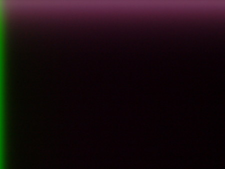

Quite recently my Fuji FinePix F401 digital camera went on the blink, in that the LCD screen on the back of the camera was showing discoloured and distorted images. Images that were captured some weeks ago appear fine, but when I try to shoot any new pictures they just show up as wavy black and purple lines. I think that the camera's sensors must be faulty. On approaching Fuji in the UK, they want an extortionate £79.90 to repair the camera which I feel isn't worth it considering the price you can get new cameras for these days. If anyone has any answers to my problem, I'd love to hear their comments either on this forum or direct to my email box. Thanks.

The fault symptoms outlines by 'Davros' above have occurred today with my own Finepix F401 (3 years old, but not used that frequently). Today I took one picture which turned out satisfactorily - but after that the LCD screen became a kaleidoscope of pulsating colours. Then the screen momentarily displayed a series of coarse lines, and a picture taken while in this state produced an image of.... coarse lines! Images already stored can be viewed normally, both on the camera's LCD and via the camera's cradle/desktop computer link. I've tried disconnecting then reconnecting the battery, but the fault persists. In view of the comments above (and the views expressed on other sites devoted to malfunctioning Fuji cameras), it would seem that to pay for a repair might not be wise since the same thing could easily happen a few months down the line. Fuji must be stupid to allow such poor quality equipment to be placed on the market... I'm inclined to write off the F401 and look for a more reliable camera.

That's a good diagnostic, P J. Based on your diagnostic, I would think that the CCD sensor is bad. Might want to look on Fuji's site and see if there is a recall on Fuji sensors. Sony and Nikon been recalling some of theirs.

I purchased my Finepix camera in ???? and, up until now, was glad that I chose this model. I�m very pleased with its functions etc.
Unfortunately, however, the camera has now developed a serious fault which means that it can no longer be used. The symptoms and details of which are:
- The camera will switch on.
- It will display old photos on the LCD which were stored on the media card.
- When switching the camera to the function which allows new photos to be taken, instead of a �viewfinder� image being displayed, the LCD screen is blank/black.
- When an attempt is made to take a photo, the photo is displayed as being blank/black.
- The flash still operates etc.
- The camera will still record sound.
- Sometimes there is a purple flicker which flashes across the LCD.
