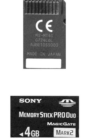

I too have a warning message when I turn the camera on.I have the DSCH20.It seems to record video and still pics okay anyway.I just press middle of the control button,and the warning message disappears.the I am attaching a scan of the card I have installed.
Michael Dowling
