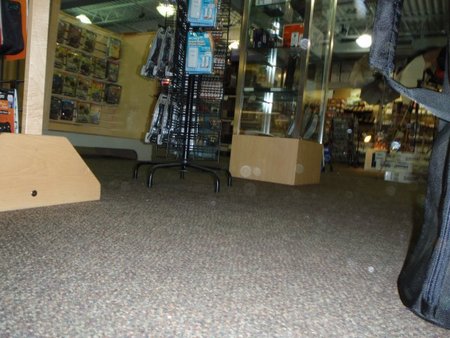

Has anyone noticed anoying Orb (or globes) appearing in your pictures? At first
these artifacts appeared at random and I thought there were particles of dust between the lenses or even within the glass. I did some problem determination and narrowed the problem to the location of the flash with the lens. I've had the camera replaced 3 times as a result of this (plus 1 time for leaking and 1 time for missing lens frame). I've come to the conclusion that the sw1030 has a design defect. I attached a sample picture taken at the store that I bought the camera.
If you haven't seen this in any of your pictures, here's an easy way to reproduce the problem:
