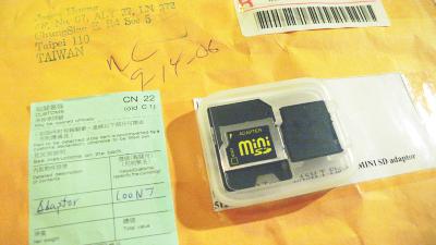

A week later, a light, puffy yellow envelope arrived at the footsteps of my door. It's an international mail from Taiwan. The package contained a small SD Card case with a miniSD-to-SD adapter and a microSD-to-miniSD adapter. The transparent case is the same case you get when you buy a miniSD card with a SD Card adapter.
The included miniSD-to-SD Adapter is pretty similar to the one supplied with SanDisk miniSD Cards. They both got a metal plate on top. Except for the red SanDisk label, this adaptr has a yellow/black label with no brand name. The microSD-to-miniSD adapter, on the other hand, has no label at all and is completely black. The plastic mold does not have an uniform surface, and looks kind of cheap.

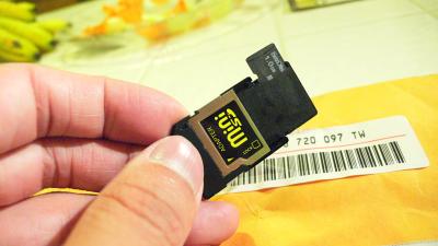

Sliding the microSD into the side of the adapter is a bit scary at first. The tiny microSD looks very fragile. And there are no markings on the adapter on how the microSD should slide in. Aligning the tiny card to the slot wasn't easy at first. I was too afraid of breaking the card or the adapter to apply any force.
But in the end, the microSD slides into the miniSD adapter as you would expect, contacts of both cards should face down. And firmly pushing the microSD card into the adapter is the best way to insert it. I slid the combination into my PDA phone and it works great.
After inserting the microSD card into the miniSD adapter, you can no longer place the miniSD adapter back into the transparent carrying case. The microSD card sticks out on the side just very slightly. However, it's possible to insert the combination into the miniSD-to-SD adapter and then place all three cards into the carrying case.
